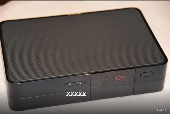

  • marekthomasx1's avatar
    marekthomasx1
    Hi All. Dave’s solution is partially correct however it’s MINUS to do so. Flick power off on the V6, press and hold the Minus button and switch the switch back on until you see a welcome/starting up screen. let go of minus. meanwhile, should see a download arrow appear momentarily. if this doesn’t work, Faults T1 can replace the box via an engineer.
    • OliverHS's avatar
      OliverHS
      This method absolutely just worked for me, after trying the above mentioned power & plus method a few times that absolutely DIDN’T work. I wish I had read this before spending an hour on the phone with Virgin customer service, being told to try the same reboot options a 5yr old would know how to do - basically I kept being asked to switch it off and on again. The agent at no point ever suggested power off and on again with holding the minus button - how can they not know this?! Utterly appalling service from Virgin. Boggles my mind they can’t tell me this and a forum of users can.

    • dadslad's avatar
      dadslad
      Can you please tell me where this MINUS button is supposed to be on my remote? Neither my old V6 remote or new 360 remote has one.
      Thanks
        Hi dadslad
        The button is on the front of the set top box, on the left, and not the remote.
