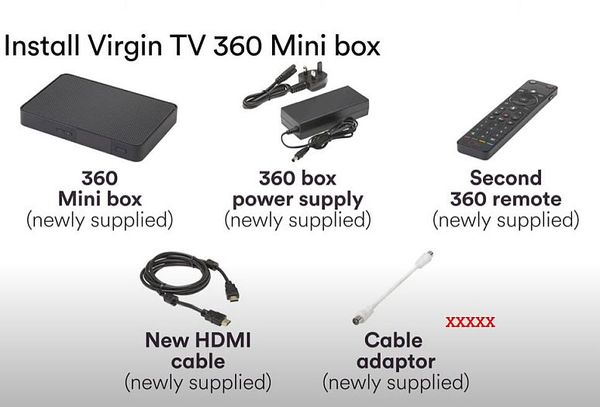

    One previous poster with this issue solved it because, "The white converter lead mush be a bit dodgy. Upon wiggling the cable the 360 box picture broke up. I swapped the lead for a standard f type to standard ariel adapter and that solved that problem. "

        The "white converter lead" I mentioned is the small white cable that goes into the back of the 360 box. It links the coaxial cable to the 360 box in my set up, but if it's flimsy it can affect the box operation. It's shown around the 2 minute 14 mark in the youtube video <Here>
        (It's the cable adaptor in the picture below)
