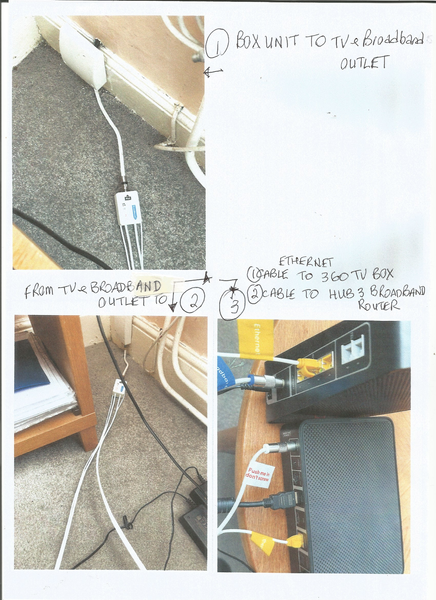

Hi -The ethernet connection between my installed 360 TV BOX and Hub 3 was lost today. The fault shown on my TV SAID IN ORDER TO Start up again I had a to input my broadband network starting VM----- and password to restore my TV channels and Apps. The cause of the fault showed as a very slow signal strength due to the ethernet connections at each end of the cable were loose and I was urged to make sure the connection between 360 TV BOX and Hub 3 was securely tightened. Are your ethernet connections securely placed in the ports? My connection at the end of  the cable is my issue as I am reminded when an app is not able to download because of insecure and loose connections which are not clicking into the ports but are unstable causing connection issues .Hope the Virgin media Team can help me either by replacing the existing ethernet cable which causes a very slow signal strength with another one which will connect in place with a click in each port and send a great signal strength.

      The yellow connectors are not working together to produce a strong signal by ethernet as recommended to use over a Wifi connection. At this point I would consider an upgrade to a more reliable Broadband Router .With this in mind, please can you pass on these images to an engineer and will you be able to  lmplement  an appointment for his visit to install the next generation Broadband Router on my behalf
      Thank you Garry

    HERE IS THE UPDATED IMAGE ,AND AS CAN BE SEEN AS EXPLAINED WITH THE PREVIOUS IMAGES From the BROADBAND AND TV OUTLET ARE 2 WIRES.ONE WIRE SPLITS AND HAS THE ETHERNET CABLE INTO THE TV BOX AND COAX CABLE CONNECTED TO THE TV BOX
    THE OTHER WIRES SPLITS AND HAS THE ETHERNET CABLE INTO THE ROUTER AND COAX CABLE CONNECTED TO THE ROUTER.
    THIS IS A JOB I CANNOT DO TO TEST FOR A STRONG SIGNAL , THAT IS WHY AN ENGINEER WOULD THE BEST PERSON TO DO THIS.ALSO AS SUGGESTED ABOVE WOULD LIKE AND UPGRADE

    Your explanation is just confusing. There is a coaxial cable splitter with one leg to the hub and the other to the 360. There is an Ethernet cable from the hub to the 360. Change the hub LAN port and if this doesn't work change the Ethernet cable.
    If the ethernet cable is loose at either end, or connected to the 360 but not the hub then the onscreen message advises, "Connect an ethernet cable from your Virgin TV box to the hub".  It doesn't ask you to input the VM SSID or password if  connecting by ethernet cable as  the connection is made automatically between the hub and the 360 box providing the ethernet cable is attached to both the hub and 360.
    However, if I want to connect the two devices wirelessly then I only need to click on the VM SSID in the list and enter the password if it hasn't been saved.   If I wished I could also connect wirelessly by clicking on the WPS button on my hub and then highlight WPS within in the 360's Settings > System > Change connection type > Wifi setting
    Looking at the pictures you've posted, the hub3 and TV360 box are so close together that you don't need the ethernet connection.  If you used a wireless connection instead then the connection speed would be perfectly fine for streaming and catch up services.
