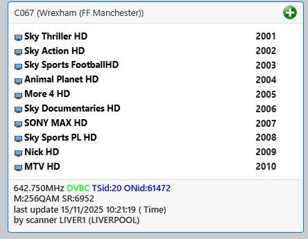

      The live TV channels are carried on muxes, and some of yours are grouped on the same mux (screenshot below) which denotes a signal error.  This normally shows up as pixelation and not a loss of a channel(s) because if  one channel on the mux is affected then the rest should be too.
