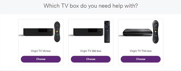

    Hi papaslavs​
    What do you mean by the, "VM start up"?
    Which TV set top box do you have?
    You say you've just updated from tivo to 360 via a remote.   The older tivo box can't be updated by the 360 remote. That tivo box needs to be swapped out for a TV360 box.
    Do you mean that you have a V6 box (this runs on tivo)  as this box can be converted to run as a 360 box?
    Have you actually completed the upgrade from V6 to 360? If so have you got the correct input source  (HDMI port) on your LG TV set so you can see the TV360 screen?
    Which actual LG TV do you have?  For example LG OLED48C46LA or LG 43UR78006LK
    Your LG TV will probably automatically tune into the 360 if you have enabled 'One Power' in the 360 settings (System > One Power)  and also have enabled  SIMPLINK (HDMI-CEC)  on your LG TV.  You might find this under Settings > General > External Devices > HDMI Settings > SIMPLINK (HDMI-CEC)
