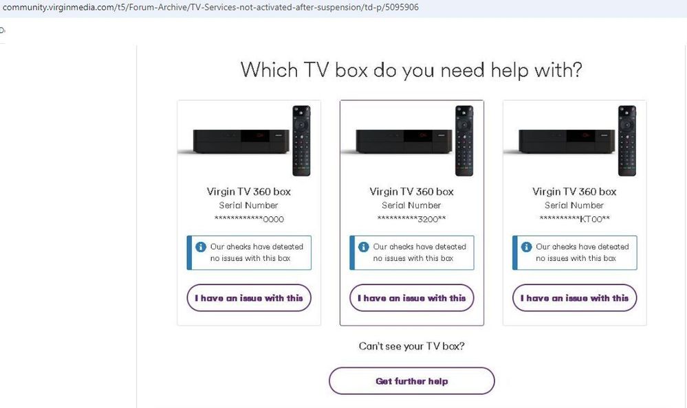

I've included the image of the three boxes you have (below) that you posted when you had issues previously.

If you have 3 x 360 boxes are they all updated V6 boxes or did you have an old TiVo box swapped for a 360 mini box. If they are all updated V6 boxes and one is faulty then it will get replaced with a 360 mini box.
You would need to clarify what the faulty box is before anyone would send you one, picture below is of a 360/V6 and 360 mini box.
