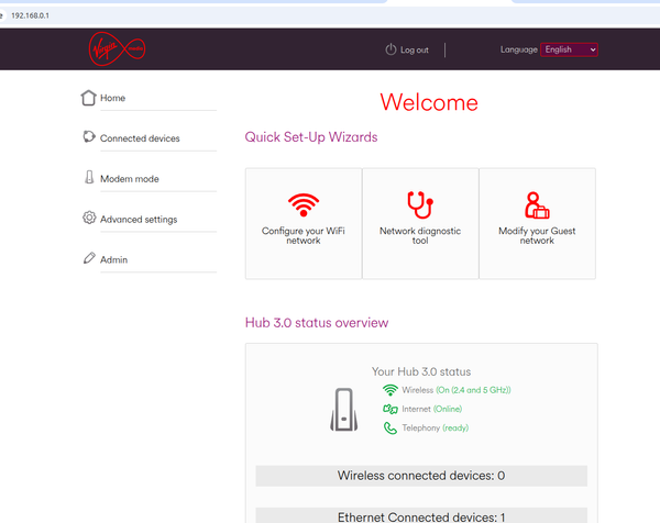

Today I go to use the phone and no dial tone. Signed into the Hub settings and it says Telephony (Disabled)
Is that because the Hub is in Modem mode, or is there another problem?

  • It's working!!
    I don't what they did, but this is now Hub number 4!!
    When they left they said that there was nothing left that technicians could do and that it was up to the operations centre.
    I don't know what they did or what the issue was but it's now all working
