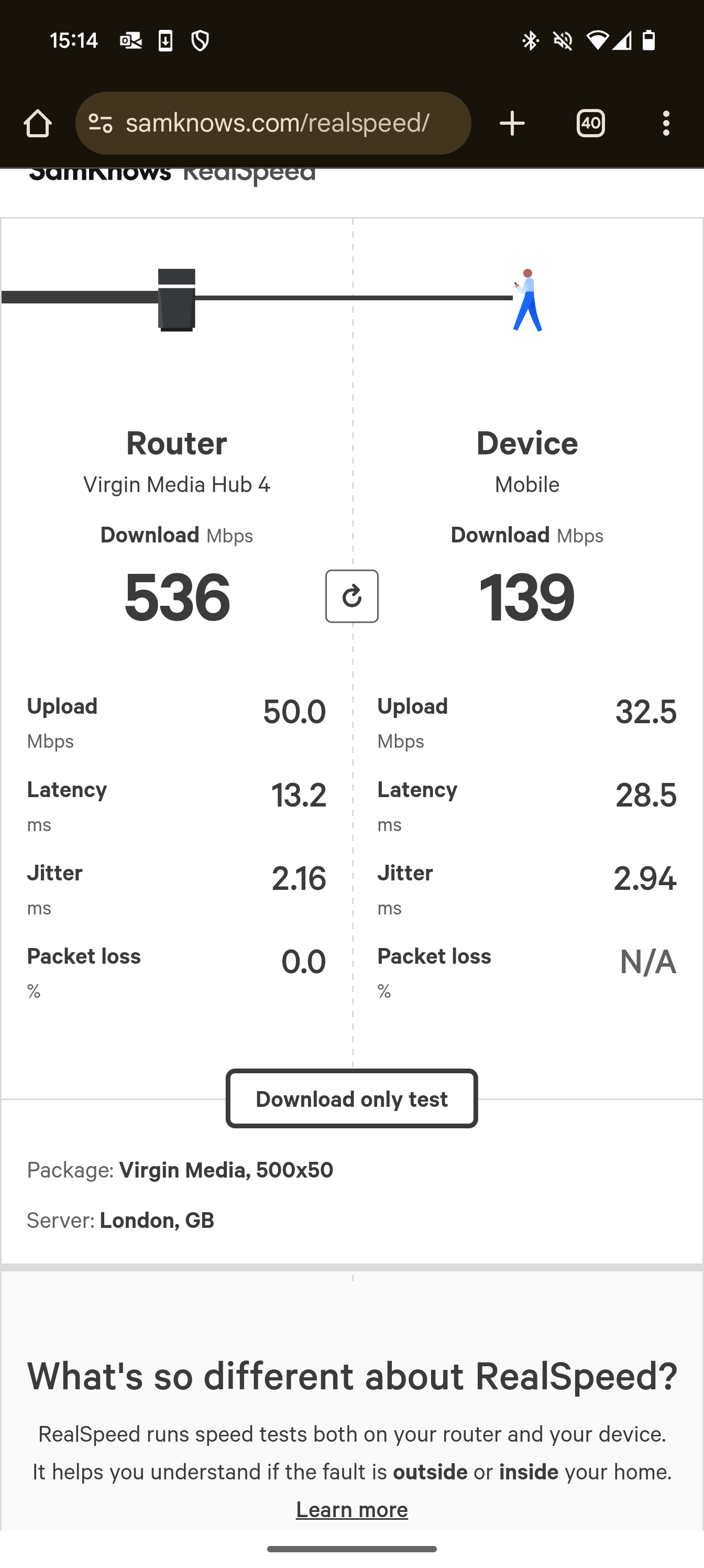

Upgrade to 1gb only producing 500mb to hub
As the title suggests, I recently upgraded to the 1gb service.  However I am only receiving around 530mb to my hub 4.
Results shown below.
 I have power cycled the hub in case that was the issue but no change.
Please advise on a fix.  (I'm assuming a Hub4 is capable of 1gb speeds and I do not require the newer Hub5 to facilitate this?)

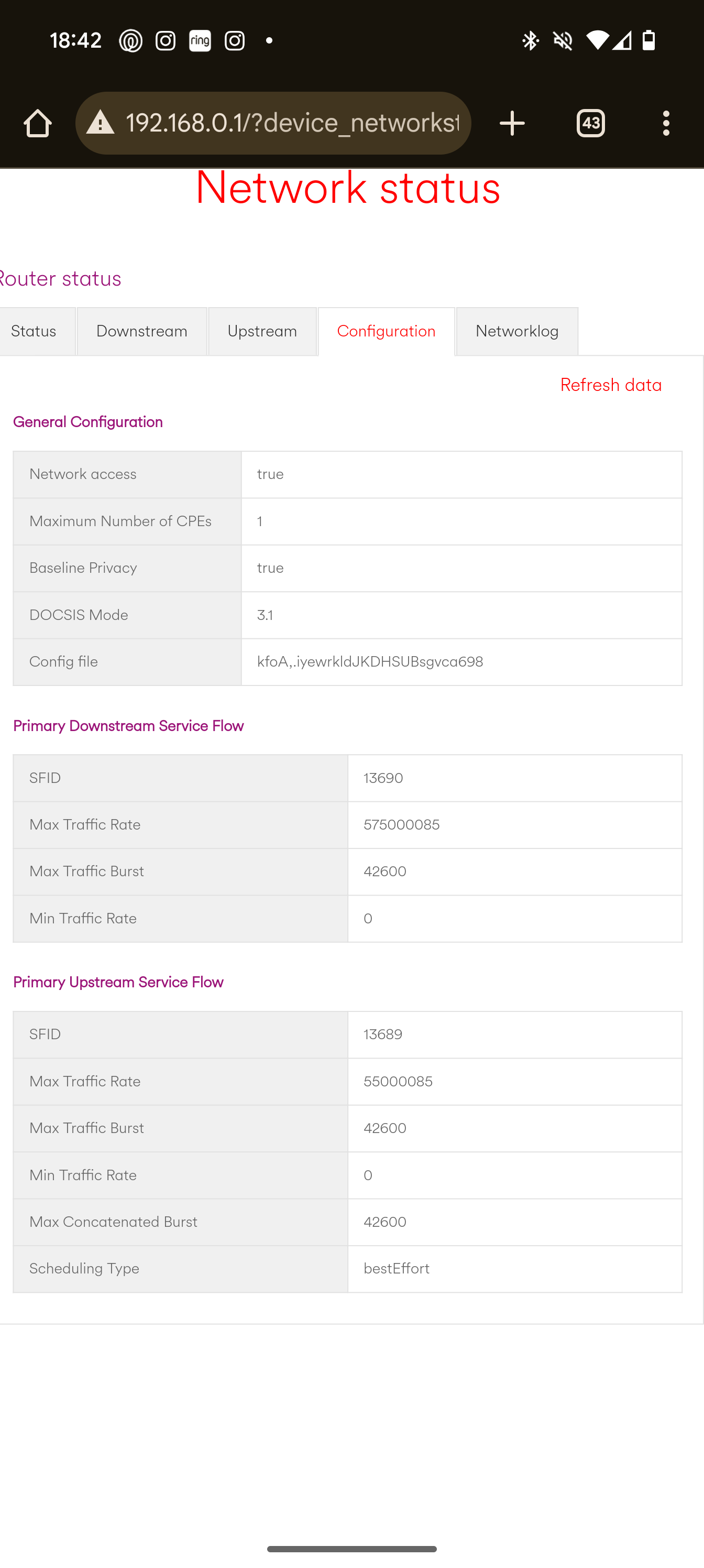

    • DavidStevens's avatar
      DavidStevens
      Thanks for the quick response.  Infor requested as below:
       Im guessing that means
        DavidStevens
        I'm guessing if I'm only getting a max traffic downstream rate of 575000085 then the upgrade has not been applied?
      DavidStevens
      General Configuration
      Network access
      true
      Maximum Number of CPEs
      1
      Baseline Privacy
      true
      DOCSIS Mode
      3.1
      Config file
      kfoA,.iyewrkldJKDHSUBsgvca698
      Primary Downstream Service Flow
      SFID
      13690
      Max Traffic Rate
      575000085
      Max Traffic Burst
      42600
      Min Traffic Rate
      0
      Primary Upstream Service Flow
      SFID
      13689
      Max Traffic Rate
      55000085
      Max Traffic Burst
      42600
      Min Traffic Rate
      0
      Max Concatenated Burst
      42600
      Scheduling Type
      bestEffort
  • Your provisioning hasn't changed, hence no speed change.
    You could try a reboot, or a full reset, however, it might need sorting by VM.
