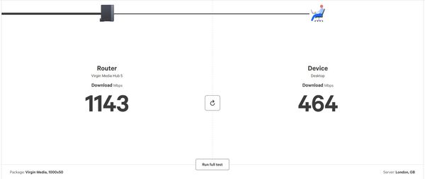

Sudden poor 1GB Volt Broadband speeds
Hi all
I have had the 1GB "Volt" package for a long while now, and usually speed tests show outstanding results (minimum 1GB download and 100MB upload, pretty much all of the time).
However just recently I have been getting download speeds varying between 200MB and 600MB, and it does not seem to go above this.  Upload however is still good at 100MB.
I have rebooted the router / PC etc. many times.
The connection is wired, not wireless.  The PC is directly connected to the router.  I generally use a USB connection, but have tried switching to Ethernet as well, but it makes no difference.
I have enclosed an image which appears to indicate the issue is not with the speed coming in to the router.
Nothing has changed, so I am mystified about this, and would greatly appreciate any ideas!

    Hi and thanks for the reply.
    In Safe with Networking, the speed on two tests was 1GB.
    Mark

      So your device is at fault.
      You need to determine which software is causing the slow down, usually Antivirus related.

    Thank you.  Do you have any advice on what steps I can take?  Tried disabling Norton, and a good few other items running in the background, but to no avail.
    System is actually pretty 'simple' - I don't have a lot of software or things running in the background.
    • carl_pearce's avatar
      carl_pearce
      Superstar
      Well technically it's 'known' to be software since you see full speed in safe mode with networking.
      It's possible to disable each startup item from task manager, with a reboot in between, to determine if it's one of those items at fault.

    Problem found.  Norton.
    Whilst I had previously "disabled" it, I decided this time to completely uninstall it, and test again.  Low and behold, the speeds were immediately up to 1GB again.
    Reinstalled Norton and speeds low again.
    I shall now try to do battle with Norton....
    Thanks again for all the help in identifying the issue.
