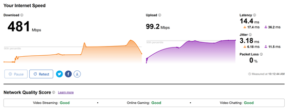

  • Just tried a full reset. Speeds up to 481mb ethernet.
