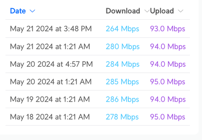

Hello,
My speeds used to be fine since Virgin come out about a year ago to run a new cable, although I noticed the last week or so I am getting less than 300mbps. Can someone check my figures to see if something is out?

Speed tests were carried out from my router hardwired into the modem.

  • Phone line says no issues in area. I am using a 3rd party router to the Virgin hub which is in modem mode. Unfortunately It's a bit of a pain to switch the hub from modem mode to router mode to do a Sam Knows test. The speeds I am getting are from the routers speed test which is hardwired to the modem. As I said in the original post, everything has been fine for a while and nothing has changed on my side so I know the setup on my side does work at full speeds, something appears to have changed though.
    VM will insist on the Hub being in Router mode before they will do any troubleshooting. You should also do the SamKnows speed test as VM will most likely ask for it anyway.  You can go back to modem mode once you have run the speed test.
