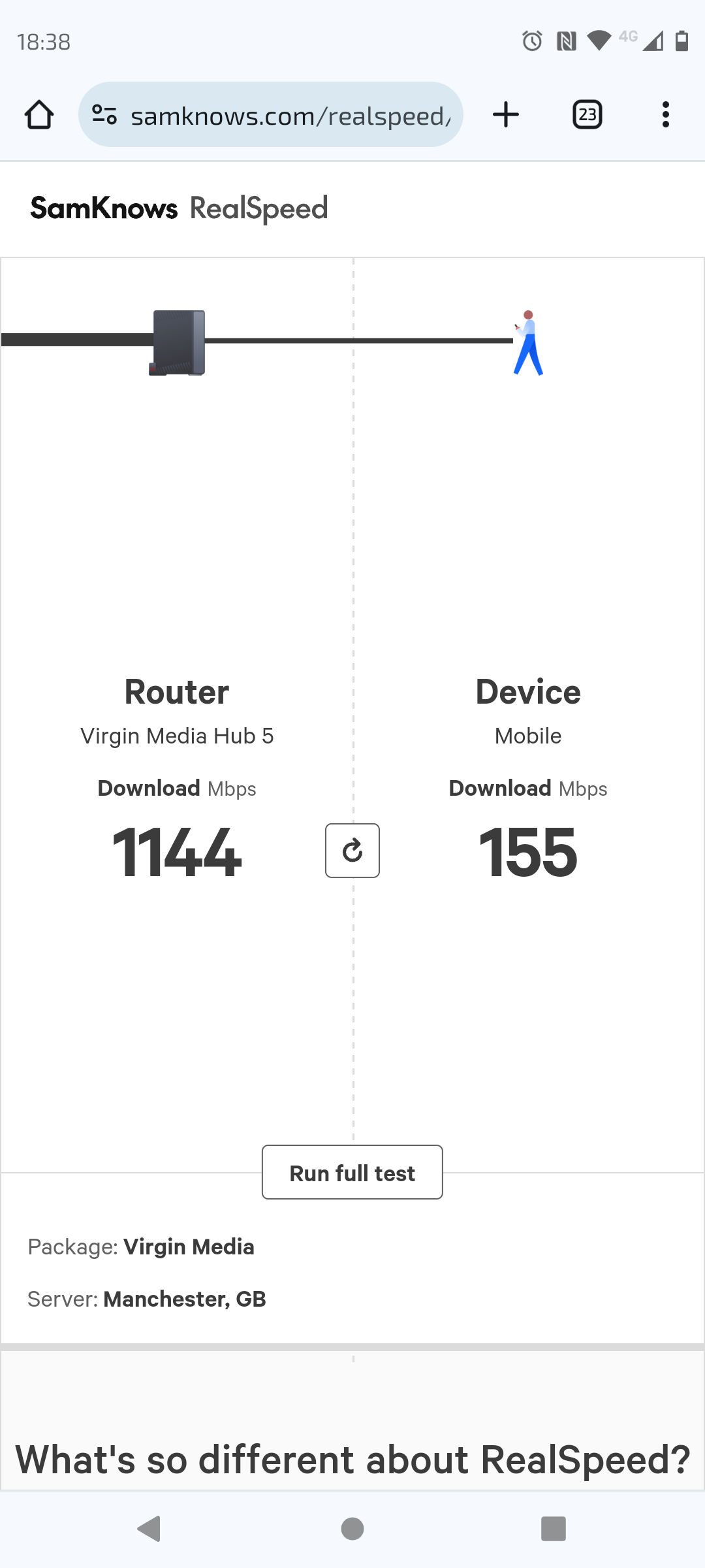

Samknows says I'm getting 1145 at the router but even stood next to the router I can no longer get anything over 300meg.

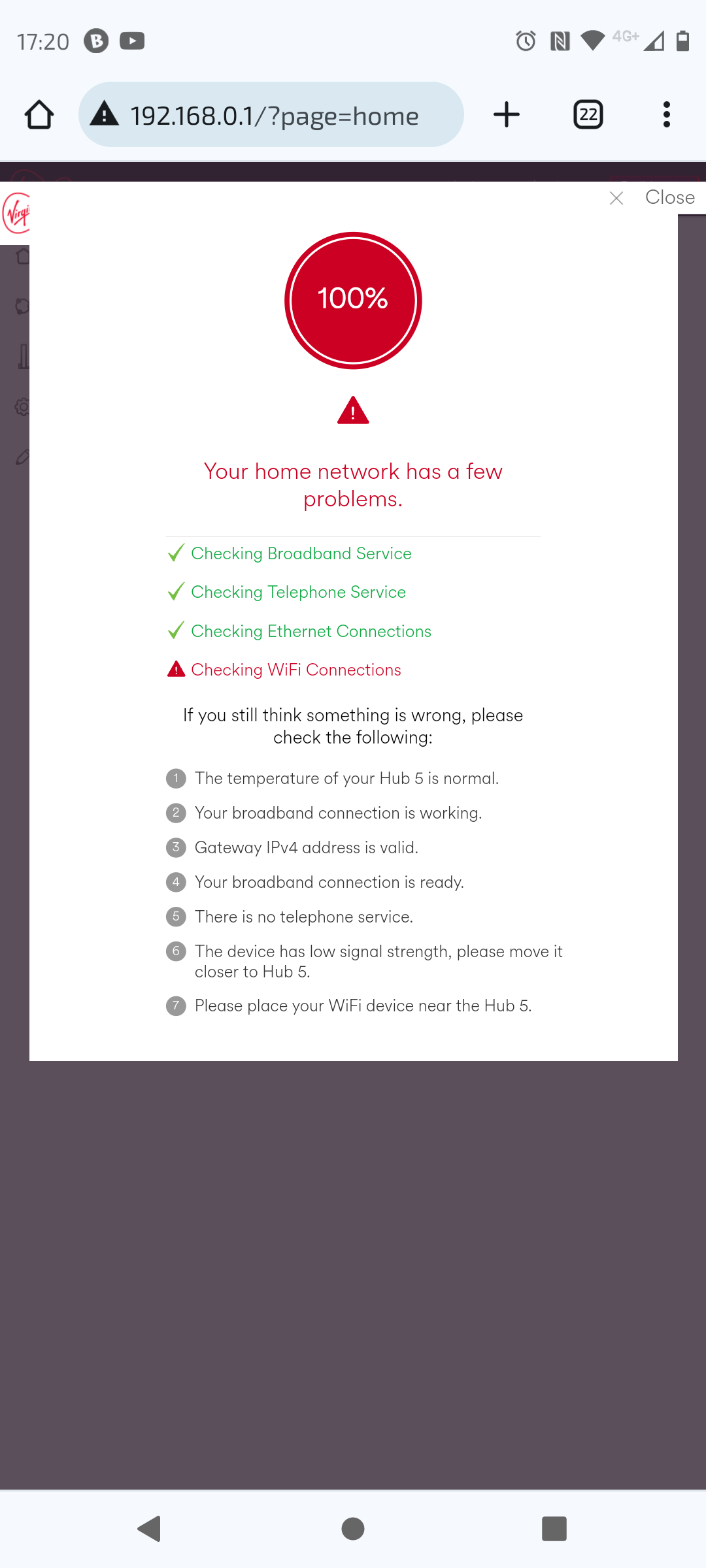

I run diagnostics and it says there are problems with your WiFi, and I run them on virgins broadband checker online and it tells me to reset my hub which I've done several times but still the problem seems to persist.

      Firestick is circa 866, phones 433, firepad around 75,
      Not sure if these are normal or correct, I'm just surprised that when I run speed tests on these devices I'm getting less than I was with my hub 4 on 500 meg. I know speed isn't everything and other than needing a WiFi pod sending out to boost the signal to the front of the house everything is working pretty well.

        The challenge with wireless is technology moves on with different standards. So, the HUB 5 will have different wireless standards than the HUB 4 you had previously.
        Roughly speaking you should see around 2/3 - 3/4 of the connection speed as your download speed to each device.
        On top of that the pods aren't great so won't provide very fast speeds (minimum guaranteed is only 30Mbps).
