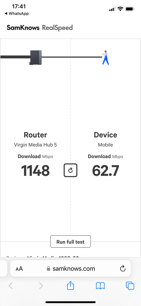

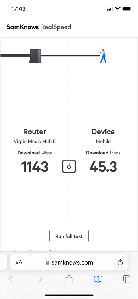

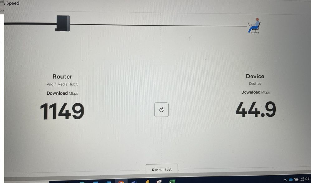

Below are my test results from when I spoke to technical support last night -
Test taken on Mobile (bedroom upstairs with booster)Speed when I was 1 meter away from routerWifi on laptop when I was approx 2 meters away. (apologies for quality, was speaking to support over whatsapp)

    I'm assuming you got a new Hub 5 for 1Gb.  These are Wifi 6 ax protocol devices and can cause issues with some older IoT devices. The speeds you are seeing over wifi suggest your kit is running over the 2.4Ghz band, and not the 5Ghz?  The Pods may help, especially the new "black" Pods, as these are also Wifi 6 ax devices.  As for wifi, VM only guarantee 30Mb in any case, so unfortunately it may be up to you to resolve the wifi problems?  Have you tried a wifi scanner from the Google Play Store, to analyse your property?
    At least, on the upside, your circuit is getting the full 1Gb speeds to your Hub, so I would expect a top wired speed of around 940Mb on a 1Gb NIC.
