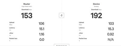

    Look at the Configuration tab of the Hub 5, what is the Max Downstream & Upstream rate profile showing ?
    Share a screen shot of the Full Test results from Realspeed this will explain where the speed is being lost.

  • legacy1's avatar
    legacy1
    hmm 0.0 packet loss guess thats for upstream? your downstream must be shot or bad routeing or a bad [REMOVED] DDOS
