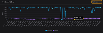

New 1 Gb install - upload limited to ~85 Mbps
I had 1 Gb installed last week in an area new to VM. Regardless of whether in router or modem mode, upload very rarely moves past 85 Mbps. I've seen 90 Mbps occasion, but it's usually 75 -85 Mbps.
Tests conducted with cat6 cable directly into the hub if in router mode, or to my UniFi UDM if in modem mode. I've tried restarting, and I've tried a factory reset.
If I switch the WAN connection to use my Openreach FTTP 900/100 connection, using the same devices, cable, and NIC, I get 100+ Mbps upload every time.
The Samknows real speed also shows this behaviour.
I know ~20 Mbps upload 'missing' might seem petty, but I want to use VM as my main line and downgrade my FTTP to a slower package as a backup line. I run a fair amount of cloud backups, a site to site VPN etc, so the quicker the upload the better, and I signed up recently with the news that VM had bumped speeds to 110 Mbps.
As you can expect, trying to report this as a fault has been... challenging. Is there a mod who could look into this please?
Thanks

    On thing you could do is on the UNA set up a speed test to run every day at say 04:00 and this should show what it’s like in a non busy time.

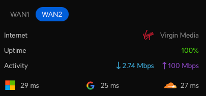

  • I already have a Speedtest docker which I posted a screenshot of. The issue has never been about times of day, it's been an issue at VM's end since the day I reported it, and thankfully it finally appears to have been fixed.
    Once the cloud sync has finished I'll plug my Mac directly into the hub in modem mode and do a sam knows real speed plus normal Speedtest.
