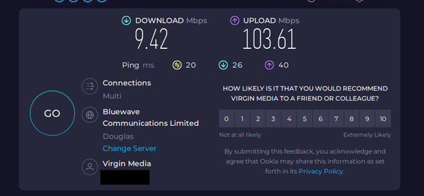

I've performed a speed test (speedtest.net), from a machine attached via ethernet. Prior to this problem starting, I would regularly see speeds in excess of 700mbps. Now I'm lucky if I see more than 10mbps.
Also, you'll notice my upload bandwidth is ~10 times my download bandwidth, which is not right from how the service is contended (the upload speed seems about right though, from what I remember).

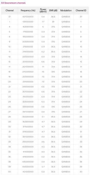

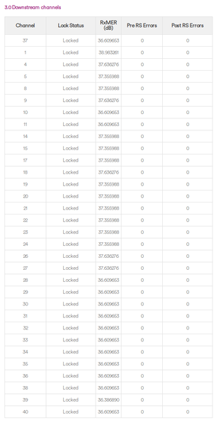

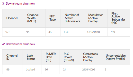

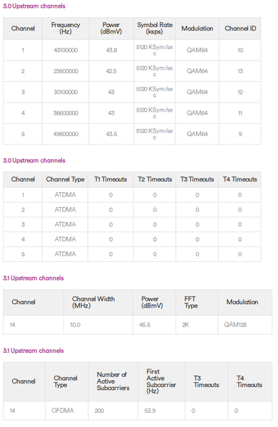

Here are the Downstream and Upstream network status details from the Hub 4. From what I can see I do not have packet loss/noise issues.

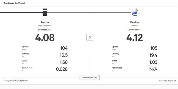

  • Hello everyone, thank you for the helpful suggestions. I've now switched back to Router mode so I'm able to run the tests with samknows.com/realspeed and remove any doubt. Here is what I'm seeing after the Hub4 has been up for a while:
    As before, immediately after the Hub4 was rebooted, I was seeing 900Mbps+ on the samknows realspeed test.
    These tests were done with ONLY my test device connected to the Hub4 via ethernet, and with the Hub4 wifi disabled. So I am certain nothing else is using the connection during the test.

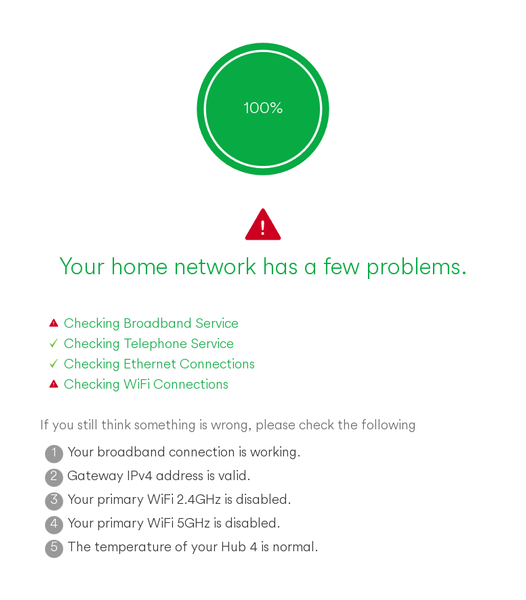

    Since I'm in router mode, I also ran the "Network Diagnostic Tool" on the Hub4. It does report an issue, but I don't believe the gateway address is anything within my control (I disabled wifi as I have my own, and all these tests are done on an Ethernet connection)
    Temperature of the Hub feels normal to me; its also not moved from where its installed for over a year though!
    The download speed is very poor but the upload speed is quite normal.
    You are unlikely to be the only one in the street suffering this degradation.
    Have VM reported any known issues yet ?
