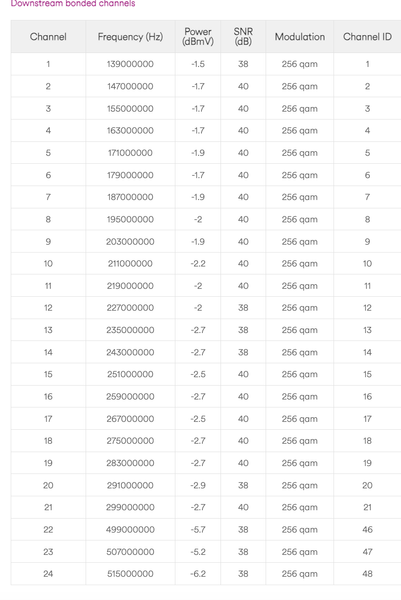

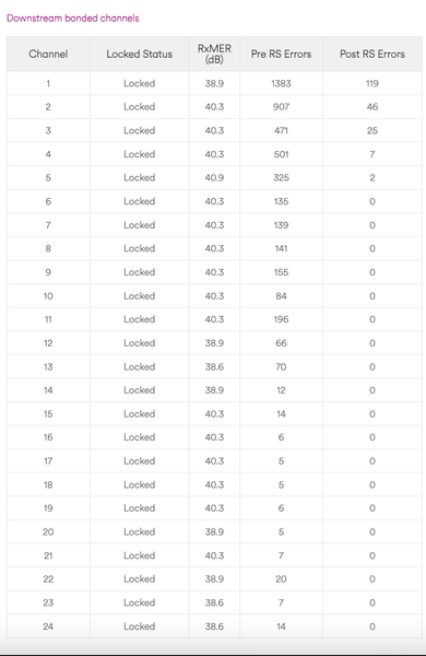

    Please post the power levels and network log from the Hub.  It might show some clues?  As an aside, if you are on a DOCIS network, it will have more latency than an FTTP connection.
    • nazuro's avatar
      nazuro
      Hi Adduxi thanks, does this help? There are some sporadic errors in the network log but not necessarily correlating with my latency issues
