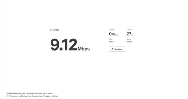

However, this morning it dropped to around 8mbps.  I do a couple of speed tests to confirm (see pics).  I also have the virgin media app and i ran the speed test on that ...and very strangely enough it ran at the same high speed as if there were no problems (ie 132mbps).  I tested at least 3 different speed tests, and all were around 7 or 8mbps except for the Virgin media one which was producing odd results.

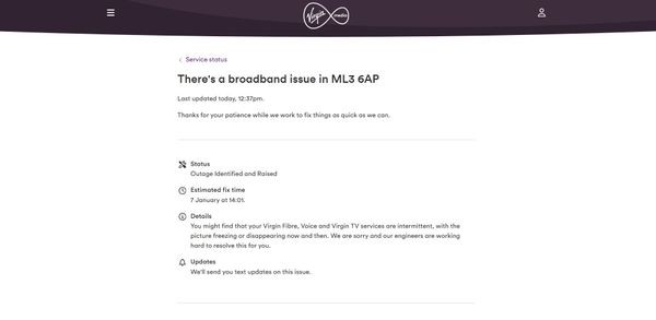

Anyway, i know these things happen no biggie and speed will hopefully go back to normal in a few hours.  My issue is this...when i check for issues in my area which could be causing this the virginmedia app reports that yes there are broadband issues in my area and it won't be properly fixed until 7th January 2026.

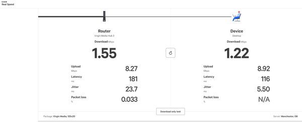

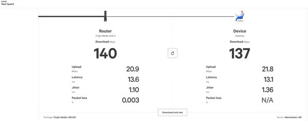

    Hrmm i think it was something to do with my ethernet cable...it was a hellish bugger to remove and i used a new ethernet cable and here are the results.  First pic is with previous ethernet cable and 2nd one is with new cable.

    Hi thats very interesting because i check multiple speedtest sites and today im getting varied results all over the place.  I will post images asap.   I also have had VirginMedia here before for years and it was absolutely fine.  On multiple devices (pc, phone) i get the issue, though one is ethernet and one is wifi.  I will try just using wifi on the pc in case of the possibility it is the ethernet cable?

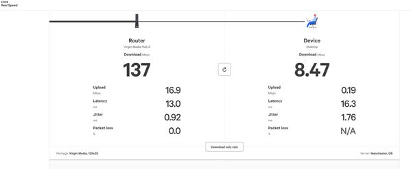

    Managed to run a full test on samknows.
    so from the pc to the router is 137?  ie basically the internal network? And 8.47mbps is external?

    • jpeg1's avatar
      jpeg1
      That means you are getting the correct speed from VM into your Hub. So the drop to 8.47 is between the Hub and your device.
      • cje85's avatar
        cje85
        Wise owl
        Yes, the test shows the Virgin Media connection is fine and exceeding the advertised speed, so it certainly isn't being affected by the fault listed on the status page.
        However, there is something wrong between the hub and the device. What device are you testing on and is it wired or WiFi?
