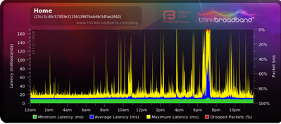

Recently my wife has said that our connection drops off every now and again, which as a home worker that uses teams a lot can become very annoying.
I have posted below some information, would be grateful if someone can say if the figures look ok or not?

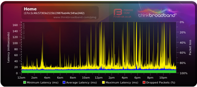

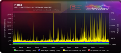

Some BQM's
Thanks all

        Post the two tables of upstream data too.
        Also, what devices are connected to your Hub on ethernet cables ?
  • An engineer came out last week to look at the main cabinet (which is outside our house), due to a street fault, he tested our cable while he was there and it looks like we need a new cable from the cabinet to the house.
