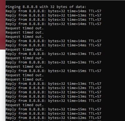

Just had VM installed and the 10gb port seems to be dropping pings like crazy, along with very high latency on speed tests 100-130ms
If I connect to one of the other ports the latency and pings seem stable, just seems odd? I only have 1gb service, so I guess no need to use the 10gb port atm.

  • Going by the very high latency during speed tests you are likely not connecting to the 10G port at 10G properly. The latency is potentially high because the 1G you end up with between you and the Hub gets maxed out.
    Worth a check your machine reports 10G and isn't showing errors on the NIC connecting to the hub.

      New cat 5e cable and swapped, no pings drop from the other ports either and 13ms, compared to 130ms and dropped pings.
      I only have 1gb service anyway, but does seem odd how it's not playing ball.

        What speed is the device you are using negotiating to (1Gbps, 2.5Gbps, 5Gbps, 10Gbps)?
        Your Gig1 subscription is limited to around 940Mbps, per device, when using a 1Gbps ethernet port, out of the possible 1130(1150)Mbps.
    dns.google is a load balancer. Behind the facade of 8.8.8.8 are a distributed farm of DNS servers.
    Did you read that all of these dispersed DNS servers have respond to WAN ping enabled ? No !
    If you with to use a DNS as a connectivity test, use it properly i.e. via nslookup
    Or via : https://www.grc.com/dns/benchmark.htm

      Google DNS is anycast and all nodes respond to pings as part of their standard configuration. DNS requests may need balancing to multiple servers behind a load balancer cluster, any balancers will deal with the ping themselves.
      This fact is used by various network equipment vendors worldwide.

      That you've a 1G NIC would've been very useful information for the first post. Use a 1G port for now, might be some weirdness between your NIC and a 10G NIC causing an auto negotiation issue. Settings on your NIC may also be problematic as well as firmware.
      When you move to 10G NIC try it again.
