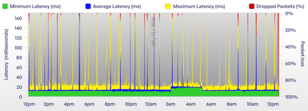

High latency only resolved with router reboot
Hub 3.0 in modem mode
Every month or so, I notice ping spikes while working from home. Upon checking the BMQ you can see it's terrible.
192.168.100.1 is inaccessible - like the web server is down or something.
When I manually reboot the Hub 3.0, everything seems to start working again. I can now access 192.168.100.1
Is this really expected, I must manually reboot the router this often?

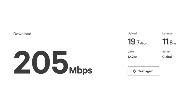

    Also run a wired speed test on www.samknows.com/realspeed and post the results.
    Once done we can comment.

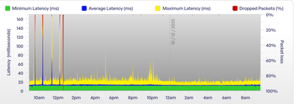

      • nazuro's avatar
        nazuro
        Been fine since I rebooted the hub at 12:45pm yesterday...
        Why was the hub struggling and requiring a reboot?
