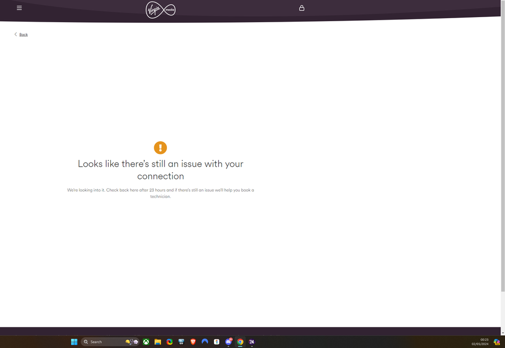

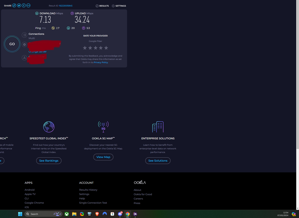

Every day at 12/1am I am losing my speed/connectivity.

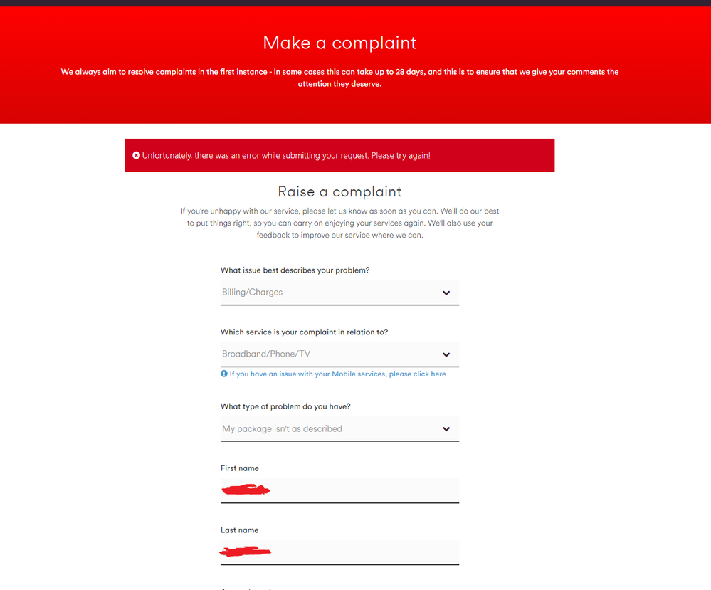

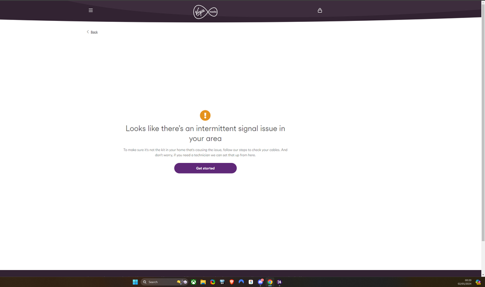

I have been losing my speeds and connectivity at around midnight/1am/2am for the past couple days. It is affecting the workload that I have to get done by the morning and when I tried to submit the complaint I am receiving silly errors.
I am on 350mb speeds, which are fine most of the days, just never at night, and never get notified if there is something going on in my area.
How exactly am I supposed to raise a complaint if the site won't let me??

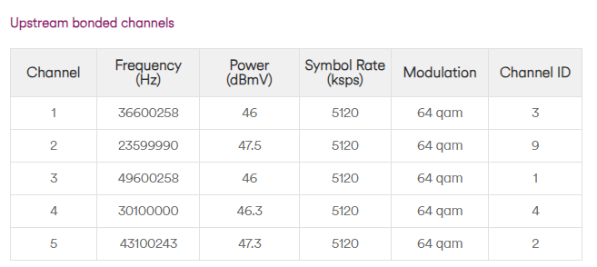

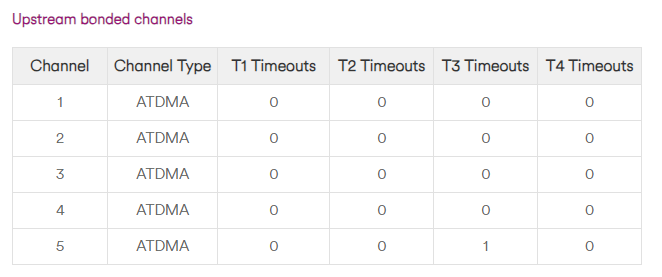

    The online diagnostics do suggest that there is a problem - can you share the router logs please?
    Go to 192.168.0.1 (or 192.168.100.1 if you are using the router as a modern) and share the upstream, downstream and network logs from ‘check router status’ - you may need to set a settings password if you are accessing this for the first time.

      Yes, I do indeed use the ethernet for my main work PC, and that's where the speed tests came from.
      Here are the logs that I think you are reffering to:

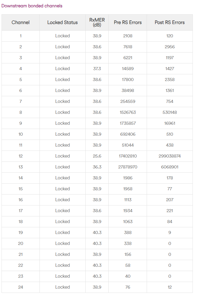

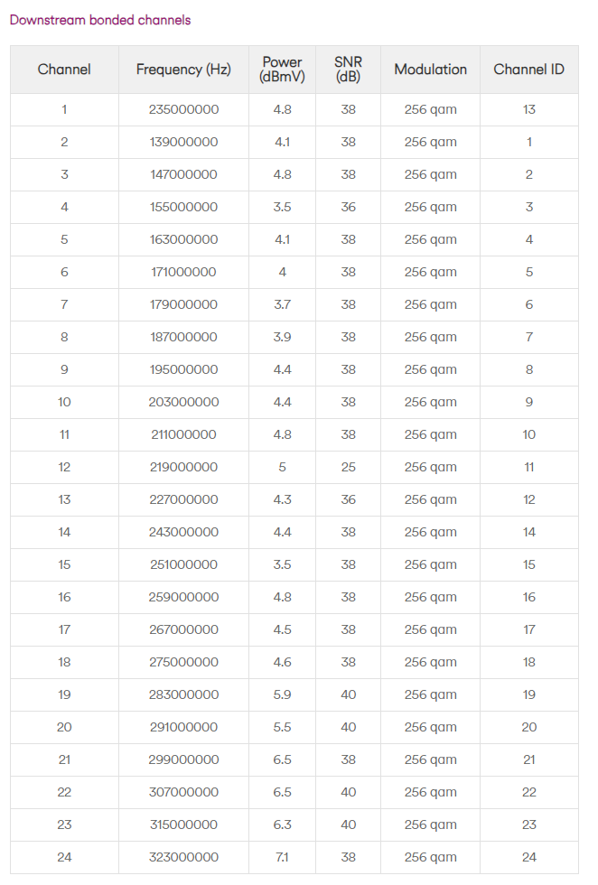

        I’m only seeing the network ones (I’m guessing you’ve uploaded the others as pictures) - please could you post them in text form?
        But so far those network logs are showing a lot of RCS Partial Service errors and also some MDD Timeouts - both indicative of the disconnects you are seeing.
  • RT123's avatar
    RT123
    Up to speed
    I can see the images now - there’s a lot of PostRS errors (if these are rising, please can you post the stats again)

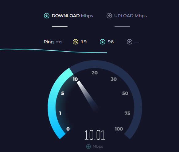

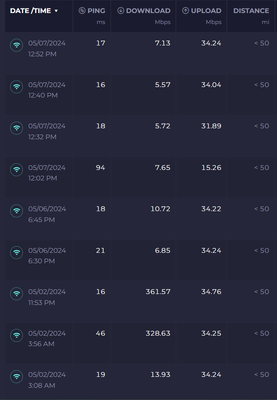

    Its been more than 23 hours since Ive done the initial checks and the problem still continues. I am not even getting 10% of my promised speeds (350mbs). I am lost for words.
