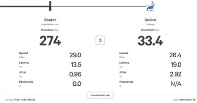

Is this over Wifi or wired? VM only guarantee Wifi speeds of 30Mb. Run the FULL tests on this site www.samknows.com/realspeed and post the results.

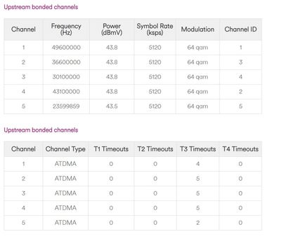

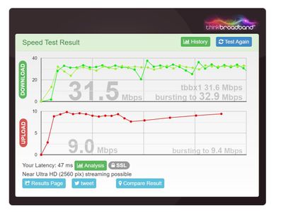

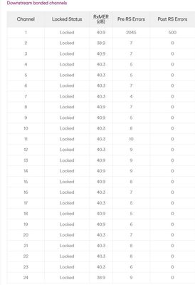

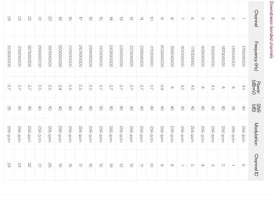

Post the power levels, Pre and PostRS errors and network log from the Hub. Also setup a BQM to monitor your circuit www.thinkbroadband.com/ping
Once done we can comment.
- arinigoTuning in
Hi Thanks for the quick reply. Can you please help with this?

- AdduxiVery Insightful Person
So the Samknows is showing full speed to your Hub. The problem lies with the device so that is what you need to focus on. How is this device connected?
- arinigoTuning in
Thanks.
Device is connected through wireless. I have this problem only for the last few weeks. It was at full speed before and I have not changed anything.- carl_pearceSuperstar
You don't have to change anything when it comes to wireless as external changes can affect wireless speeds.
Your device may be connected to the 2.4Ghz band, rather than 5Ghz.
You can check this in the 'Connect Devices' section of the HUB settings.

Network logs:
11/12/2024 11:43:49 critical No Ranging Response received - T3 time-out;;CM-VER=3.0;
10/12/2024 23:24:37 Error DHCP RENEW WARNING - Field invalid in response v4 option;CM-VER=3.0;
07/12/2024 15:46:7 critical No Ranging Response received - T3 time-out;CM-VER=3.0;
07/12/2024 11:24:38 Error DHCP RENEW WARNING - Field invalid in response v4 option;CM-QOS=1.1;CM-VER=3.0;
04/12/2024 03:40:47 critical No Ranging Response received - T3 time-out;CM-VER=3.0;
03/12/2024 23:24:38 Error DHCP RENEW WARNING - Field invalid in response v4 option;;CM-VER=3.0;
02/12/2024 14:07:22 critical No Ranging Response received - T3 time-out;CM-VER=3.0;
30/11/2024 11:24:38 Error DHCP RENEW WARNING - Field invalid in response v4 option;;CM-VER=3.0;
27/11/2024 13:44:17 critical No Ranging Response received - T3 time-out;;CM-VER=3.0;
26/11/2024 23:24:38 Error DHCP RENEW WARNING - Field invalid in response v4 option;;CM-VER=3.0;
26/11/2024 19:40:38 critical No Ranging Response received - T3 time-out;CM-VER=3.0;
26/11/2024 07:36:0 Warning! RCS Partial Service;;CM-QOS=1.1;CM-VER=3.0;
24/11/2024 01:17:23 critical No Ranging Response received - T3 time-out;;CM-VER=3.0;
23/11/2024 11:24:37 Error DHCP RENEW WARNING - Field invalid in response v4 option;CM-QOS=1.1;CM-VER=3.0;
22/11/2024 17:19:55 critical No Ranging Response received - T3 time-out;CM-QOS=1.1;CM-VER=3.0;
22/11/2024 07:12:34 Warning! RCS Partial Service;;CM-VER=3.0;
21/11/2024 13:25:39 critical No Ranging Response received - T3 time-out;;CM-VER=3.0;
20/11/2024 16:01:38 Warning! RCS Partial Service;;CM-VER=3.0; - arinigoTuning in
