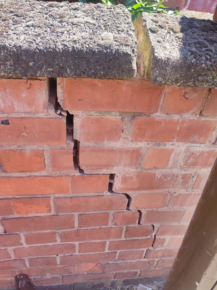

Our external wall was damaged by Virgin Media Engineers, the property is a commercial site and a Tenant had Virgin Media install a New Broadband connection, since then i have tried to contact Virgin Media, but not had any joy

      Hmmm that green moss - like growth on the inside of the cracked stone on top of the wall suggests that this is not new.

    Wow. The pictures weren't cleared when I first answered.
    I suspect there was already a crack down the wall, and the vibration of the hammer drill opened it up.

    The landlord is trying it on. His wall was already cracked, the VM drill did widen it but the repair would have been needed before long anyway.
    VM are always reluctant to pay even when they are at fault, so they are unlikely to help with this.
    Claiming a 8mm hole drilled by VM caused the wall to crack is utterly laughable.

    Indeed, what is it that the landlord is claiming that VM did to cause that damage?
    I can see two whole bricks that have been snapped along the line of the crack.
    That sort of damage would be caused by something like reversing a vehicle into the wall or undermining the foundations of the wall in some way. The fact that the wall is still in a straight alignment makes it look like subsidence or failure of the foundation IMO. Did VM dig a trench next to the wall?

    Agreed, someone has either backed a van into the wall or the foundations are poor and the return on the right hand side of the image has fallen away from the rest of it. You'll never get VM to pay out for putting an 8mm hole through it - it's not even cracked from the hole they drilled.

    There's even an old spider's web in the crack. It hasn't just happened.
