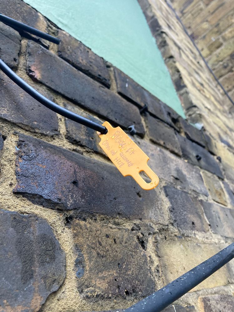

    Another engineer came on Friday 6th and put these tags on the cables. He then told me that he had booked another engineer to come out that same day to repair this. As you can see he has put tags presumably to help the next engineer to fix the cable.
  • tomg3's avatar
    tomg3
    Virgin are now telling me that I need to wait until the 23rd December for this damage to be repaired

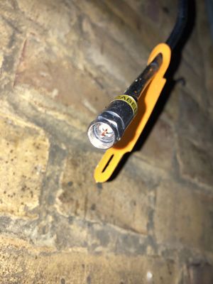

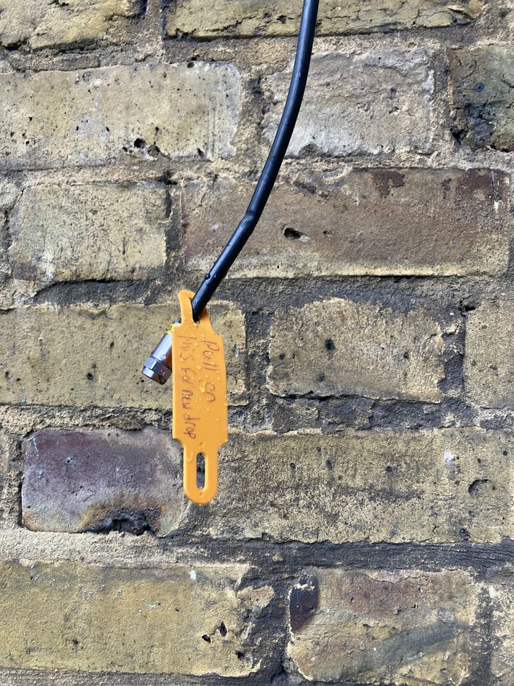

      Hi, thanks for the comment. Here are more pictures of the two ends. One of these I can see goes directly into my flat where my router is. (Left image). The other one goes down into a metal casing on the corner of the building, down into the ground with a load of other cables. (Right image). The both say 'Cabelcon 4.9'. LH cable (from my flat) says on the yellow tag 'please fit omni and reconnect here'. The yellow tag on the RH cable (into ground) says 'pull on this for new drop'. So these just need to be reconnected? Please if someone can help me understand what is going on here.

    cannot see picteres until they are approved but from your description its unclear what they have done and exactly what the description on the cable marked  "pull on this for new drop" means - so am guessing a bit - you dont say how close the 2 ends come together but if they are close then get one of these and join them
    https://www.ebay.co.uk/itm/183829316019
    if they are a distance apart then you will need to try a bit of 'make it up as you go' - so
    the above fitting or 2 and
    https://www.ebay.co.uk/itm/282077526694
    assuming the cable marked to the drop is good then that should work
    those are just examples from ebay - B & Q may sell them - they certainly sell the 1st one

    Yes, it looks very like the cable is to be used to pull a new one back to your house. That would explain the long wait, as the local VM subcontractors will have been booked to do that work.  In that case the Dec 23 date will be a nominal holding date and not to be relied on.
    If you can join the two ends and that works it would be ideal. But there are two cables on the  left. If the cut end left hanging is the live feed then joining the connectors isn't going to work.

      Thanks for the comment. The cut cable you refer to in the left image goes up to a different flat in the building, so presumably is just totally redundant. The one with the connector goes to my flat and was presumably connected until Thursday when my service went down. What does it mean to 'pull a new cable' in? The cable on the right goes into the ground and the engineer has put a connector on and tagged it 'pull on this for new drop'. Why would he have put a connector on it if it isn't a working cable? And if it is a working cable, why didn't he just join them together? (They can reach together and touch easily)
      • -tony-'s avatar
        -tony-
        good questions that no one here including VM staff cannot answer - buy a connector and join them up - costa a £1 or there abouts and it might do all you want - long term it needs an omni box which is what the tech has said - they are usually fitted by contractors
        to pull a new cable means just that - a new cable from the street cabinet to your omnibox - thats the ideal solution but if its with outside contractors it could be days weeks or months - the date you have as said above is a holding date - no guarantee they will come on that date
        the puzzle [to me] is why they cut a good connection that was working to connect a new customer - its not unknown for tem to piggy back onto an existing cable - you and the new customer dont need a unique cable bck to the cabinet although thats the usual method
        so as said go spend a £1 or so at your local B & Q and see what happens - if it works you are there until they finally turn up - wrap it in waterproof tape and [hopefully] you will be running and fine
  • jpeg1's avatar
    jpeg1
    Pulling a new cable means using the old cable through the ground or duct to pull a new one. In the worst case it could mean digging.
    But first try joining the cables with a suitable adaptor, and wrap it with waterproof tape.
