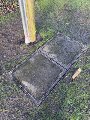

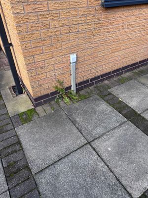

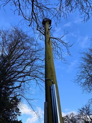

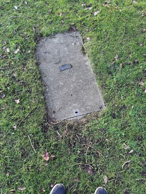

  • My office, where the BT cable comes in - this is where I want to VM cable.  its around 40m from the telegraph pole.
    the said pole where the want to run the cable, and the covers next to it.
    Another shot of the upper end of the said pole that holds the cables right now.
    Cover outside my neighbours house.
  • jpeg1's avatar
    jpeg1
    If it's XGS-PON then forget the coax. Is the pole on your side of the road or opposite? If the VM cable is feeding a pole on the opposite side they will certainly want to use the pole to feed you.
