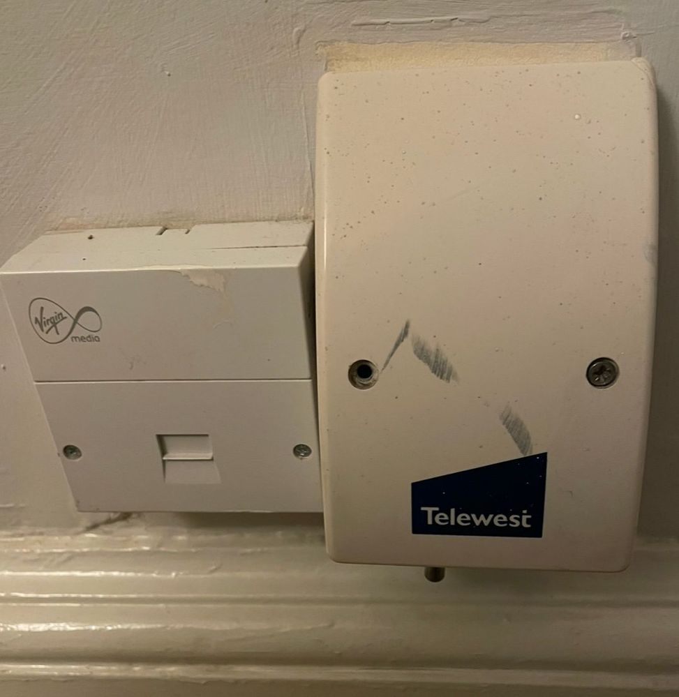

I've just moved to the UK and into a flat that has a very old looking "Telewest" cable connection point, beside a slightly less old looking Virgin Media (Phone??) connection point. See picture.
Can I in 2023 connect a modern Wi-Fi Hub to this and expect it to work - 1) At all? and/or 2) At the expected speeds?

    Should not be a problem, although the box looks to have a terminator on the screw terminal at the bottom. This just needs to be unscrewed and the cable from the new VM hub is pushed onto this screw terminal.
    • nodrogd's avatar
      nodrogd
      It is actually the phone connection on the left that is now obsolete for new customers, as the telephone now plugs into the modem/hub & not through separate wiring.

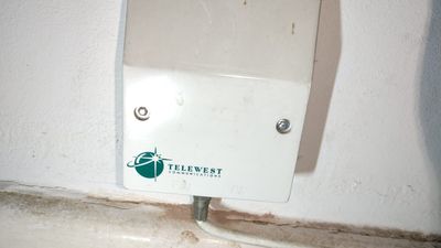

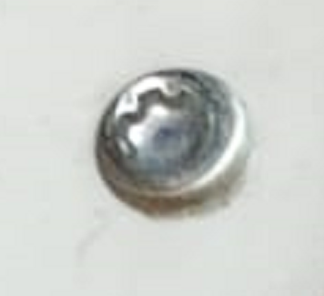

    Is my ancient installation. As you can see, they put it right on the skirting board so instead of curving the cable has to make a right angle. The end of the cable is fitted with an F-connector. This is not compatible with the supplied push on cable. Speaking of incompatible, you may also have noticed the security screws. I had two sets of security bits (89 bits in total) and neither set has something that is even remotely close to those heads
    If I do manage to get this open will I find a connector inside that I can use; or should I just call for an engineer?
  • I can't edit my previous message but I'd just like to add, those screws are raised not hollows.
