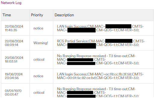

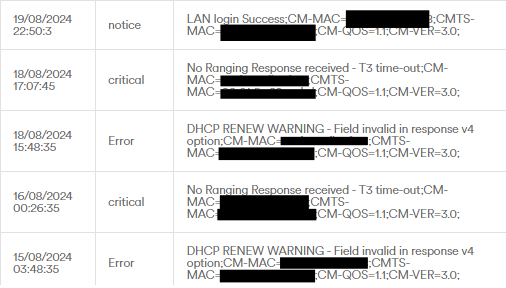

As to the issue at hand, I am experiencing outages at random times every day despite the lack of any scheduled engineering works. I've had virgin media for over a year and this is the first time that this has happened. The outages themselves would last between half-a-minute to half-an-hour. In that time, I would go around and troubleshoot everything and even hop onto my phone's data plan to check the virgin media broadband test site.
Here is just a snippet of the logs I get (RCS Partial Service, No Ranging Response, etc.):
Network Log 1/2Network Log 2/2

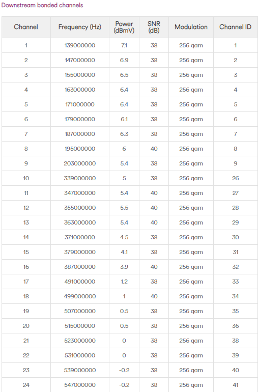

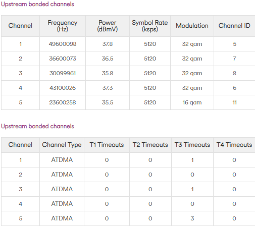

Here are the statistics for Downstream Bonded Channels and Upstream Bonded Channels:
Also, please take a look at the amount of errors I am getting. I do not know if this is normal (obviously there will always be some data loss in everything due to various reasons, but I still do not know if this is the norm).
Downstream Bonded Channels #2
Any help would be greatly appreciated.
Thanks in advance.

    Check with Area faults on 0800 561 0061 If you have a VM landline 150 this goes down to post code level. You could also try the web page status, but this is not recommended as it only covers issues that affect a very large number of customers.
    VM will not dispatch any technicians while an area fault exists.
    If no area faults found:
