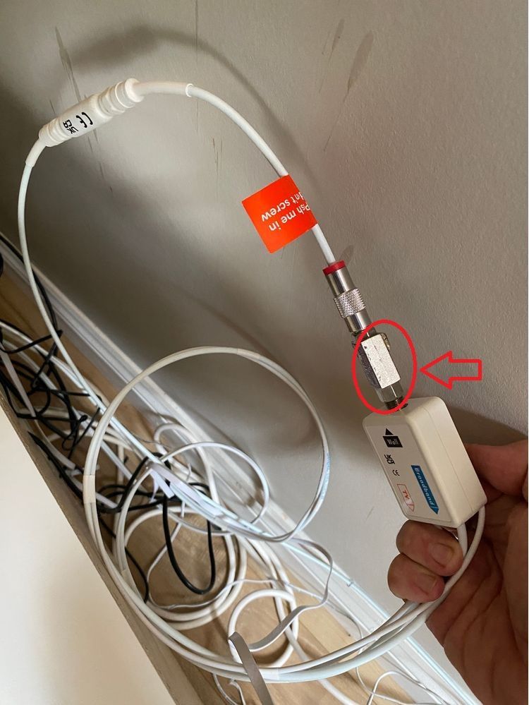

Hi - recently moved house and where the previous owners VM installation was didn't suit and we had ours installed in a different room. Now, we've decided we would like to use the original location! FYI - our new install appears to come from the original junction box outside. I've tested the original point just with a coax cable and the home screen loads, but when I select a channel it doesn't load. There is a message pops up saying something like live TV isn't available. If I take all the wiring from our new installation (attached) and equipment, is it likely this original point will work?

    It might work, but with significant cable changes like this you would be better off getting a £25 technician visit to rewire and make any necessary signal level changes.

    Unplug the red cable & unscrew the attenuator from the splitter (circled in red), then push the red cable directly into the splitter & see if that works. If it doesn't then it's likely that only one point is connected to the drop box outside & this needs to be modified.
