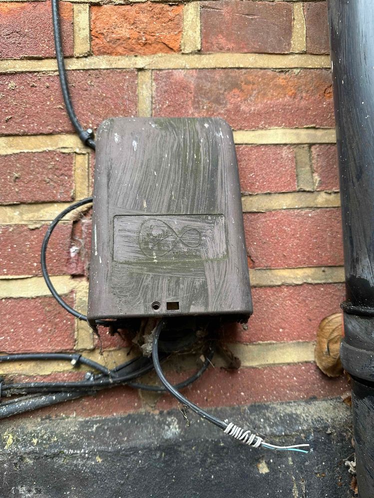

I have recently bought a property and moved my Virgin contract. Today I have tried to install it but found out the coax cable doesn't fit what I have.
I have attached pictures of what I have.External box
This is the external box.

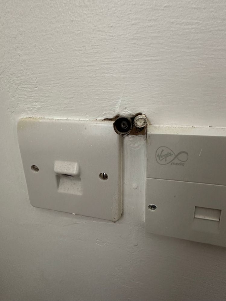

What I believe to be where the virgin cables should go
I believe the cable should go on this one but unsure, confused by the cables shown in the next picture.

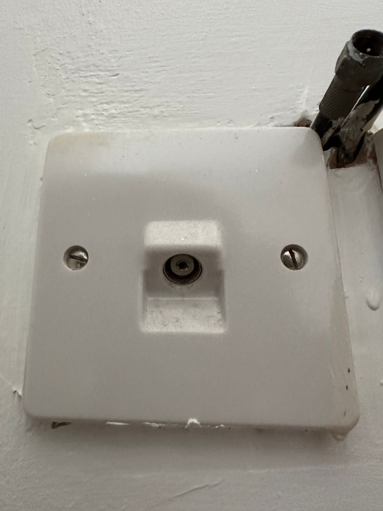

Everything that is on that wall
Not sure if should connect with the network cable...but I suspect not as in the previous house I had connected to the coax cable. Also, I believe the coax cable sticking out might be the tv one?

      I have tried to fit it in but the metal end is wider than the hole, so couldn't even push it in 😞
      I was wondering if that is the hub for Virgin, but I guess there is nothing else that could be...
      Thank you again!
        It may also be the other cable with the "fitting" on the end.  The other cable looks to be cut?  If that is the VM cable, you would need a coupler to fit the quickstart end. https://www.diy.com/departments/slx-f-type-satellite-cable-coupler/5028422001905_BQ.prd
        This coupler screws into the cable fitting, and the quickstart pushs onto the coupler.
