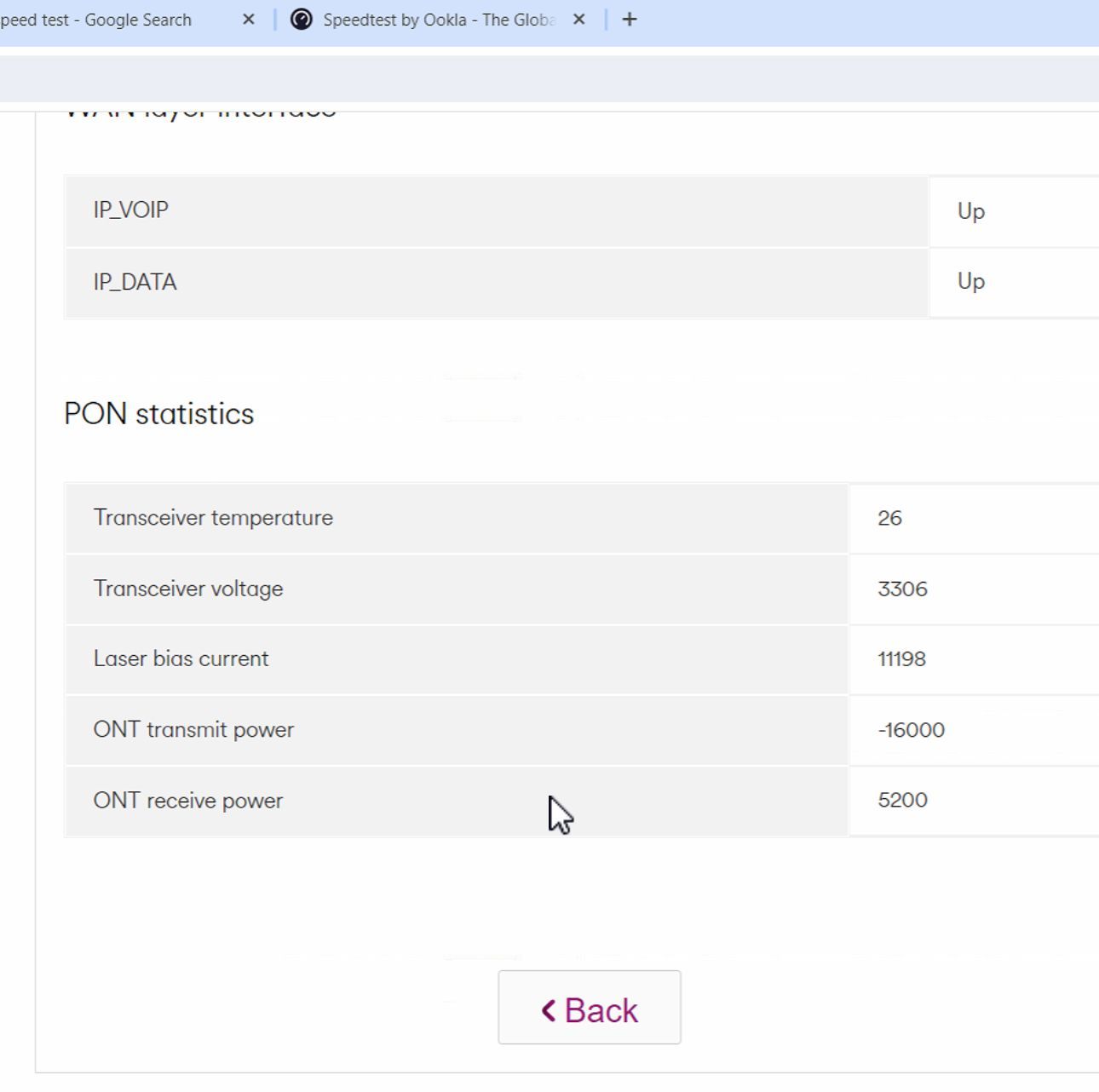

Try checking with Area faults on 0800 561 0061 or if you have a VM landline 150 as small local faults are not listed on the VM status page.

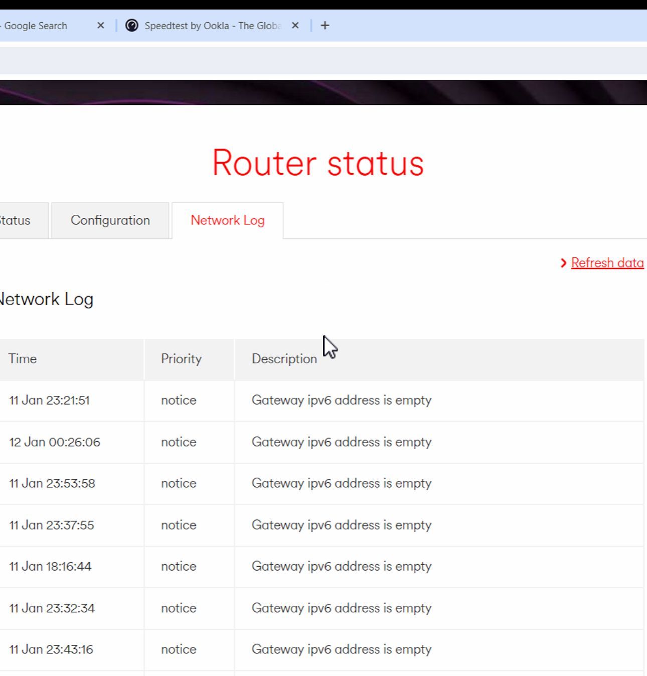

Post the power levels, Pre and PostRS errors and network log from the Hub, if there are any? The 5X is a new Hub, so not that familiar with it.

Steven_L - Chaddy_v6Tuning in
Turns out it was dirty fibre connections, technician cleaned the one outside the house after Failed scope test.
