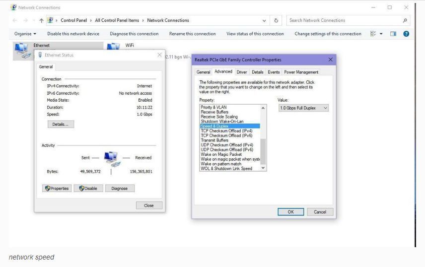

      You don;t say what type of PC you have eg Windows, Chrome IOS, however the screenshot below how to check using Windows.
      Press the Winows key and type in ethernet. Then select ethernet settings. Then check the  adapter settings. Double click Internet and it should show the speed as indicated on the left of the picture below.
      If you need to change it change it, click Properties followed by Configure then scroll down as shown on the right and set the value to 1.0 Gbps Full Duplex.

  • Had a look into the pc network settings and although it has a gigabit Ethernet card and my hub sees it as a 1gb connection as well I do not have a full duplex option.
