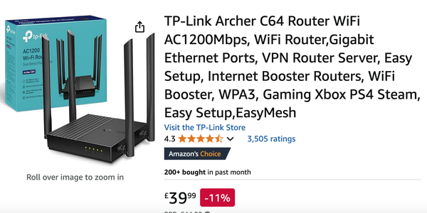

    Do as goslow recommends - we did this ourselves and used one of these in access mode - works brilliantly

      Would the TP link wifi router be compatible with the Virgin router? Is it easy to set up or does it need a professional to handle?
      • jbrennand's avatar
        jbrennand
        Yes its a doddle - my son set it up it in 5 minutes. We also used a wifi scanning App to check what channels were  in use at that point - so you can connect to the least used channels around you.  2.4 band should be set to either channel 1, 6 or 11 - least  in use at the new location.
        Only difficulty is running/hiding the Cat6a cable :-)
        Just leave the Hub as it is and set the TP-Link to access point mode (as per its instructions) using their App.  Ours has the 2.4 and 5 GHz bands set to different names (TP2 & TP5) with the same password - that allows you to connect to the most appropriate network but not essential can let the box "decide" if you prefer
        Has 4 ports for wired connections too.

      May I pls ask, could I use this in the main house as well to strengthen the signal? Would it interfere with the pods I already have?

        Hey DrNik80, thank you for reaching out and just to jump on we would advise only to use one set of pods.
        Using this and pods may affect it overall.
