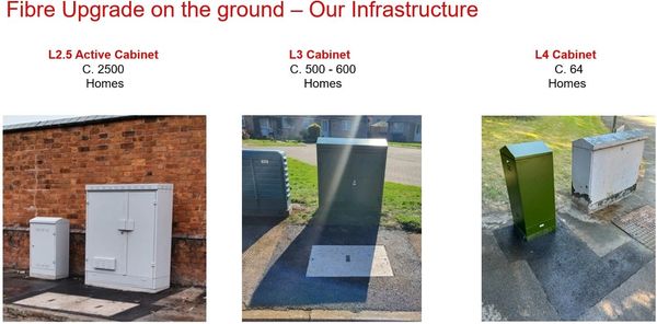

    We are an RFoG street, we have 150m of fibre from the street cabinet to the house, the fibre is run in a green "micro-bore tube" which is tough and resistant to casual damage, for us this is buried under the ground only appearing for about 15cm under the Omnibox.
    Where VM are deploying XGS-PON from telegraph poles appears to be in streets where there are already OpenReach telegraph poles or possibly mains power poles in place & no history of HFC or RFoG. The external fibre runs in a black "micro-bore tube" from a passive optical splitter on the telegraph pole to the home.

    VM are only using telegraph poles where there is no existing VM underground ducting. If you are in a legacy HFC area, you will either already have, or will shortly see, new fibre cabinets being installed alongside the HFC ones. Both will use the same ducts & boundary tees to connect to customers houses.
