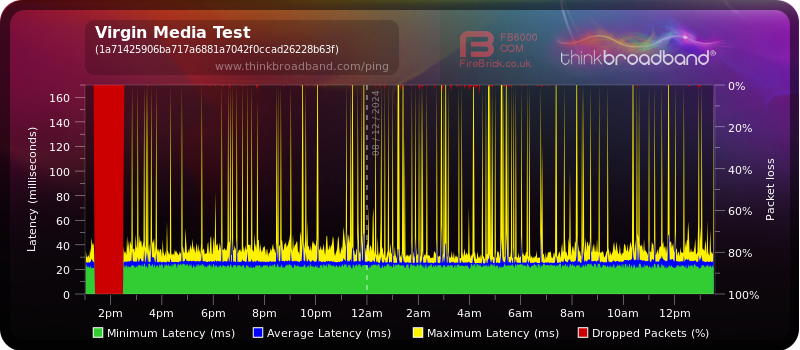

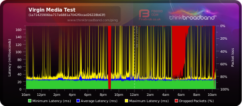

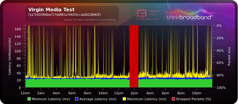

I don't really understand the Think Broadband Quality Monitoring graphs but here is a typical connection graph we used to get at the beginning of October.
https://www.thinkbroadband.com/broadband/monitoring/quality/share/006af32641b153dd2bd253a57622f0f167eba1f2-01-10-2024
 This is today's
https://www.thinkbroadband.com/broadband/monitoring/quality/share/d790454fa2d892b52aa9292e387c003f845b14b8-04-12-2024
This is yesterdays
https://www.thinkbroadband.com/broadband/monitoring/quality/share/92e75568a34652eb700f5175ffc2b41809ef1805-03-12-2024

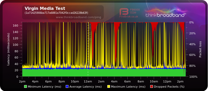

Another graph which seems to show some issues with packet loss, bit of an odd time though as we are generally sleeping through the night so if the spikes show traffic this is a bit weird.
https://www.thinkbroadband.com/broadband/monitoring/quality/share/f4fb120629d722d70b0abad6b38544f326d547ae-22-11-2024

    The BQM link that you posted showing the connection for 4th December shows that you have you have an internet issue.  Whilst you are waiting for your 'update from the engineer', it would be helpful to post the actual hub stats.
    Type 192.168.0.1 (192.168.100.1 if you are in Modem mode) into your browser URL bar and press enter.
    When the page appears click ‘Check Router Status’
     When that page appears, log in (using the details on the hub) and then go to Advanced Settings > Tools > Network Status.
    Then copy paste (don't screenshot) the information from the Downstream, Upstream, Configuration and Network logs.

    3SYNC Timing Synchronization failure - Loss of Sync;CM-MAC=**:**:**:**:**:**;CMTS-MAC=**:**:**:**:**:**;CM-QOS=1.1;CM-VER=3.1;
  • More issues which affected meetings this morning! Need to log another support request I guess though the service status is once again stating intermittent signal in your area and to wait 24 hours!

  • Original engineer not getting back to me and no response from VM Team on here. Finally managed to get an appointment booked for Tuesday after the online checker wouldn't let me due to "intermittent problem in your area".
    Spoke to several people on my estate who have no problems so can't be a problem in the area imo.
    Yesterday's BQM
    Today's BQM
    Pixellated video continues along with lag in games on different consoles etc.
  • Just an update on my post.
    Engineer attended but problem has not been resolved ab=and it's been passed on to the Network team with a date of tomorrow. Another 30 minute ish outage today too. Here's hoping they can resolve the issue.
