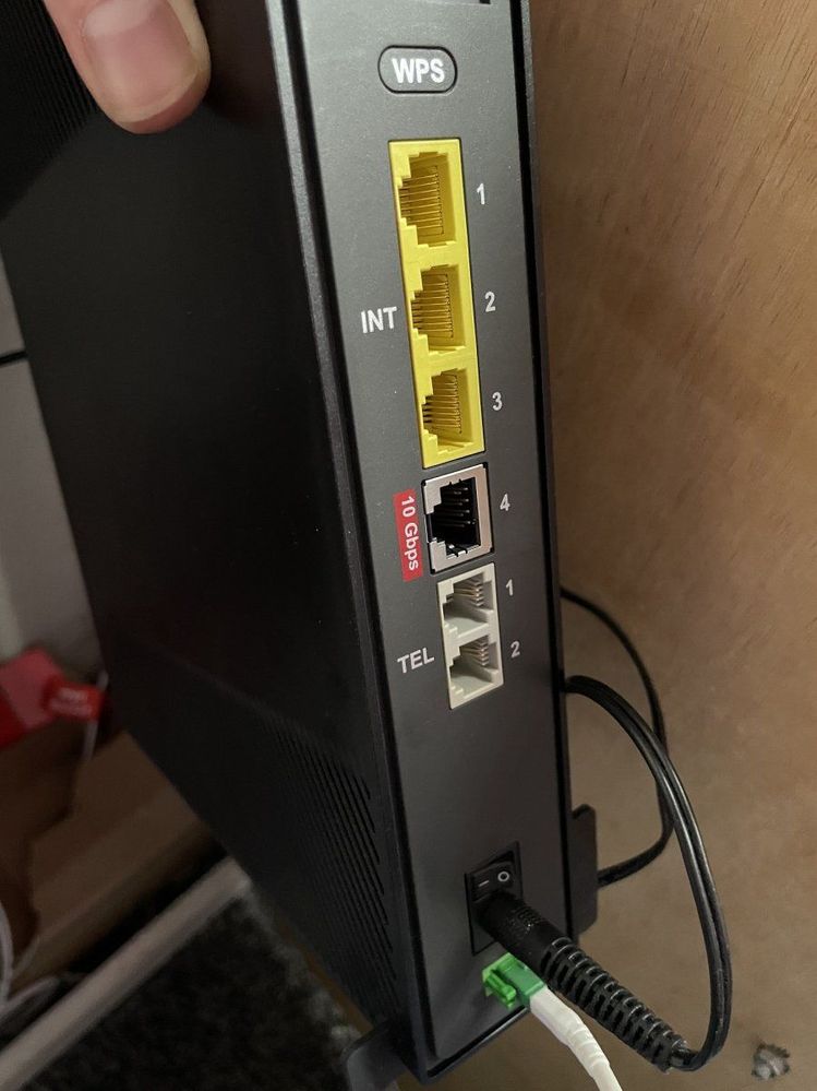

    With Hub 5x operated in Router mode, the speed on its 10Gb/s port is not limited + it has 3x 100/1000 ports.
    Note 10  Mb/s is no longer supported.
    Hub 5 x operates in Router mode, so for the moment you could attach your mesh to in AP mode to avoid double NAT.
    No time line for Modem mode has been published, so make no assumptions
    that Modem mode will be offered soon because there is a risk it turns out to be never.
    Hub 5x rear view ( image may take a while to be approved by VM )
