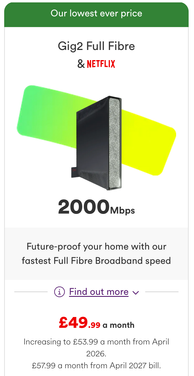

2GB showing as available when XGS-PON is not
Hi All,
I've been a VM customer for a few years and am currently on a Gig1 package. My current deal is coming to an end so have been looking at other providers, the upgrades being offered on my VM portal. I also check to see what deals a new VM customer can get by using the address of one of my neighbours who I know is not a VM customer.
When I put her address in a pop-up appeared on screen saying "Good News 2GB is now available in your area!". As I'm on HFC I know that I wouldn't get the upgrade to Gig2 showing as available for me.

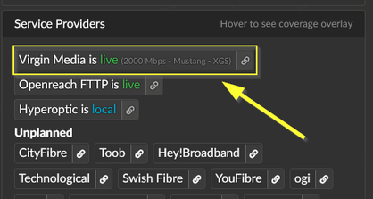

    The VM “Project Mustang” network upgrades in some areas including West Herts have been live on test for several months. This will provide 2Gig symmetrical services using the new full fibre infrastructure that has gone in alongside the HFC network (it uses the same ducts, but uses separate cabinets usually installed adjacent to the existing ones). New customers will be the first to be offered services on the new network, which will only offer XGS-PON internet with Stream boxes (360 recording boxes won’t work on it) for those wanting TV services.

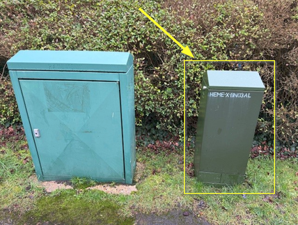

  • I called the Retentions team this morning to speak to them about a new contract. I mentioned on the call that I had seen the 2GB service advertised for my neighbour. He thought it was strange and went away to check. He confirmed that this area does not have the fibre infrastructure required. On their systems only 1GB is showing as available. He said he would raise it internally.
    That being said, in relation to the post by @nodrogd, all of the existing VM cabinets in my area did have new smaller cabinets installed alongside them about 18 months ago. Could this be in relation to "Project Mustang"? Here's a pic of the cabinet in my road:
  • I just took a look at bidb.uk for my area, and that too shows the 2GB service... and mentions Mustang.
  • Roger_Gooner's avatar
    Roger_Gooner
    The new cabinet does show that fibre has overbuilt HFC - but that's just the tip of an iceberg of hardware, software and systems needed to deliver over the new network. You can't get fibre until VM is ready to migrate existing customers from HFC to fibre, it's coming but we have no timetable.

        If Nexfibre installs fibre cables in the area, you might see GiffGaff as an alternative.  They are now also using the Nexfibre infrastructure.
    We have had those small cabs installed for a few years now.  No sign of anything else being done. I’ll not hold my breath waiting …
