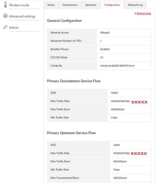

    Have you logged into your hub settings and checked what speed you are actually provisioned for?
    Type 192.168.0.1 (192.168.100.1 if you are in Modem mode) into your browser URL bar and press enter.  When the page appears click ‘Check Router Status’  then click on the Configuration tab as indicated in the screenshot below.
    Also run a speed test using a wired device on https://samknows.com/realspeed/  This will show the exact speed to your hub and to your device.

  • Thank you for your helpful suggestion identifying a good broadband speed test. This test application revealed that the connection was indeed the M350 product that I signed up for and indicated that the problem was at my end. In fact the kit I was using limited the speed to 100MB. Many thanks for that. A replacement router solved the problem.
