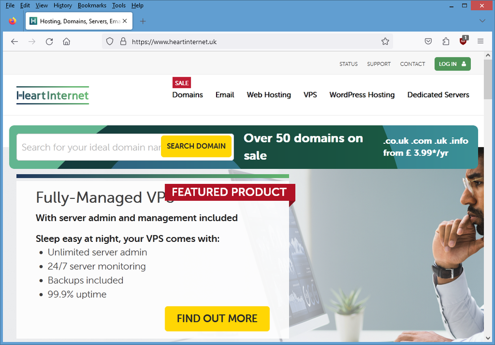

    We have VM Child Safe and Virus Safe disabled.
    Access to  heartinternet.uk  worked via our VM connection :
