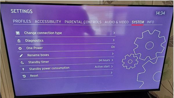

      Which reset method did you use?  he one via Settings > System > Reset?  (picture below)
      Or did you try either of the following?
      Unplug the USB from the back of the box and then hold the power button on the front of the box while  plugging the USB back in. (Keep hold of the power button while doing this)
      Keep holding the power button in when the Welcome screen appears for 5 seconds and then let go.
      A menu will appear. Now tap the power button to select which reset option (hard or soft) you prefer. I would try the soft reset option first, and if that fails try the hard reset.
      Then hold the power button again for 5 seconds on the one selected option to reset it.
