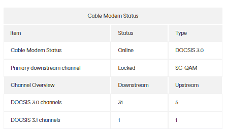

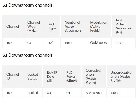

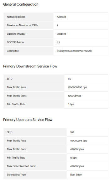

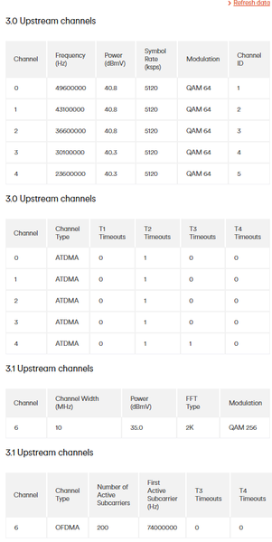

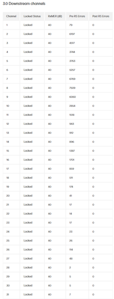

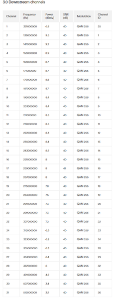

I've just set up a BQM to better track it, but here are my upstream and downstream stats directly from my router.

    Since the VM fault is supposed to be fixed, have the 3.1 Downstream Uncorrectable Errors stopped or are the numbers still rising ?

  • A couple of issues. The range of 3.0 Downstream power levels is high (3-9) and there are lots of uncorrectable 3.1 Downstream errors.
