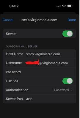

  • ravenstar68's avatar
    ravenstar68
    I'm going to answer this in stages, and I'm going to be blunt.
    I guess that is an iphone peculiarity.
    I guess you just learn to dig into the settings a bit better - SMTP is SMTP - some servers have quirks due to the security settings on the account, but if you are using the correct settings it should work both at home and away from home.
    Oh and before you criticise me - I used to be a Virgin Media customer and have a blueyonder.co.uk email address set up on different devices - including multiple iPhones and iPads across changing iOS versions.
    With regard to the suggestion of deleting the account and setting it up again.  That's not necessary.  You can edit the account settings in situ provided you don't change the incoming account type.
    1. Go into Settings->Mail->Accounts
    2. Tap the name of the Account that's giving you trouble.
    3. Tap Account settings
    4. Under Outgoing Mail Server tap SMTP
    5. Make sure there are no Other SMTP servers showing
    6. Tap Primary
    7. Ensure the settings are shown as below
    8. Note: The password field MUST be populated and should be the same password as is used on the incoming side and the Authentication type is Password.
      The email address MUST be your full blueyonder email address - i.e. joebloggs@blueyonder.co.uk
    9. Tap done when you've changed these settings and the phone will try verifying them.  If they are good they will all be ticked and you can tap Done again.
    If this fails then I'd recommend visiting whatismyipaddress.com when on the mobile network to get your IPv4 address and checking to see if the IP is listed on Spamhaus's block lists - ignore any listing on the PBL though - that's normal.  HOWEVER being as your other account can send whilst being away from home - I think that providing the settings are correct this won't be necessary..
