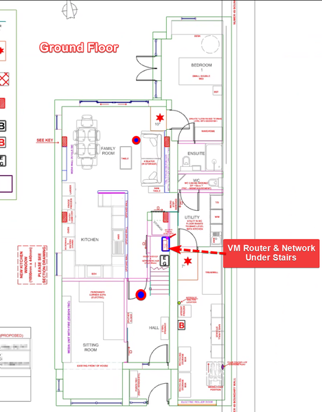

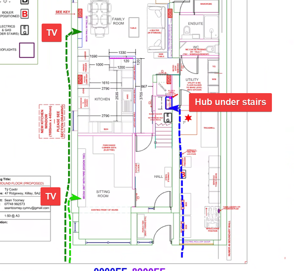

Hi all,
I'm doing a renovation and am confused about how to go about looking into the future in order to get VM in the house.
The below image shows the electrical plan I've made.
My intention is to have the router/networking hub under the stairs (purple triangle) and a VM TV box in the sitting room and family room (blue squares).
The work is still under way - internal walls for example aren't even up.
I will be using WiFi meshes, an ethernet hub & the router will be put into modem mode.
My questions are:
  1. Should holes be drilled in the external walls in preparation for the TV boxes?
  2. If so, will these holes definitely be used by VM?
  3. Is there a VM department where I can talk to someone about the plans and my intentions?
  4. How would I go about having the router put under the stairs (I want the cabling to be as un-noticeable as possible) ?
  5. I'm not sure whether I should use coaxial ports for the TV boxes - are these needed?
In the family room I intend to have a media wall and the TV going over a recess.
The TV box won't be on show - I'm concerned that by doing this we're not going to be able to use the VM box or it'll be dodgy/temperamental.
If anyone can help with the above that'd be great.

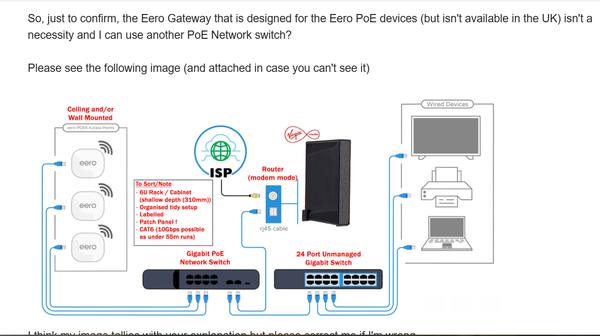

    Eero have a ceiling/wall mounted PoE access point (https://www.amazon.co.uk/eero-PoE-6/dp/B0DQB3FYGN).  They also have a Gateway (https://support.eero.com/hc/en-us/articles/8959150730267-Introducing-eero-PoE-Gateway) but this isn't available in the UK.
    This is why I was looking into the one I previously posted Labgear PoE because to my eyes, this is essentially the same.
     So, similar to how I currently have the Eero devices set up, the VM router is in modem mode and a Eero device is plugged in - this is now our modem.  Additional Eeros add to the mesh.
    I will certainly not be using the VM hub as a router - the final straw when I was getting 0.03Mbps :D .
    Instead of plugging in Eero devices and have them dotted around the house I was thinking about the PoE ones so it all looked cleaner/tidier.
    In my head the diagram I posted is how it'll work

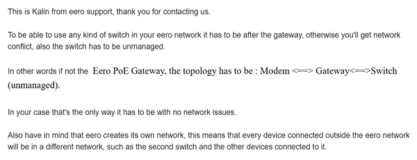

      From my understanding it needs to be an unmanaged switch, I'll go more into this below.

      This is what I was thinking.  Router cable runs though the garage and through the wall.
      TV ones run down the side of the house.
      I'd pay a VM technician to help me figure this out.  I currently don't have ceilings (or a sodding roof) and the driveway is a building site so would rather things be planned now instead of drilling though my lovely painted walls.
      Do you know if it's possible to get a VM technician out to plan things or do I need to call VM to find this out?
      I don't think my image below is going to work.... but correct me if I'm wrong.

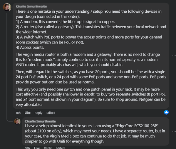

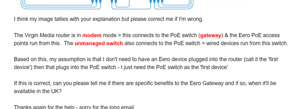

      I contacted Eero and they replied with this:
      I've only now had time to reply so just sent this - I'll send in 2 screenshots so it's not small.

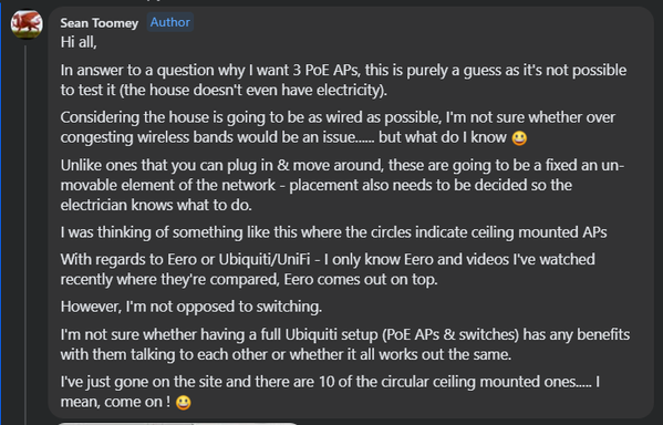

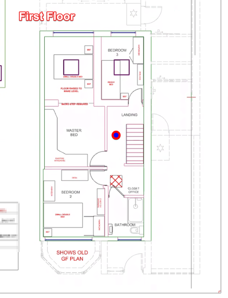

        Here's an image of where I'm intending to put the ceiling mounted PoE APs.

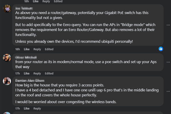

      If your plan is to put the VM hub in modem mode, and use the router function of the Eero system, then I am not sure your network schematic would work as drawn above. I have not used Eero before but online info seems to show a unit with two network sockets on the back.
      Do you not need to connect your first (designated as a router) Eero into the VM hub (in modem mode) then connect the rest of your network via the second network socket on the first router Eero. I don't think you can have a network switch as the first device plugged into the hub when the hub is in modem mode.
      As regards the wiring of your comm's cupboard, fit a 24 port patch panel to terminate the cables coming in from the rest of the house. You could fit a small comm's cabinet (vertical options are available) or a patching frame (just a bracket to support the patch panel)
      It is possibly to terminate each incoming wire with a RJ45 plug but, in my experience, the plugs eventually get damaged and the latching lever breaks off leaving an unreliable connection (unless you re-terminate).
        That is correct, but the OP has a Router in place beside the Hub, so that's fine.

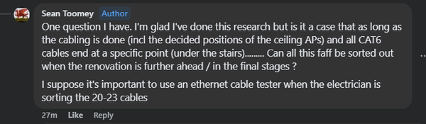

  • Hi, me again.
    Since my initial post I've now decided to be a wired as possible in my renovation.
    To the point where I'm going to have a 24 port gigabit switch, patch panels etc.
    I'm still learning about this and trying to figure things out.
    In my current house (that we rent so can’t make changes to) I have 3x Eero devices (1 plugged into the router).
    I’ve never had an issue with Eero so am going to stick with them.
    I had intended to use these in the new house (they’ll need to be plugged into the mains) but am leaning more towards PoE ones fixed to the ceilings and/or walls.
    Now, when mentioning this to my builder and electrician they said that these are only used in hospitals, offices etc.
    I initially accepted this but this isn’t the case.
    So, they don’t know it yet but I’m going to be doing it.
    As the electrician hasn’t filled me with confidence, I’m looking into all this myself and will either tell him what to do or I’ll get someone in.
    My question is this: Have I understood the setup for my house networking hub?
    The switch I'm looking at is: https://www.screwfix.com/p/tp-link-tl-sg1024d-24-port-desktop-rackmount-network-switch-black/239rn
    And the PoE switch: https://www.screwfix.com/p/labgear-60052pi-s-4-port-4-2-port-poe-10-100-1000mbps-switch-unmanaged-gigabit-poe-network-switch-black/712YE?tc=CB1

      Are you planning to use the VM hub as a router and the Eero as access points?
      I have never used Eero before but I would assume its capabilities are far greater than those of a VM hub.
        Eero do actual AP's, so those will be just PoE AP's.  They also do a full blown non wifi router, the Eero Gateway.  Not sure if it's sold in the UK though.  I prefer this method as it doesn't restrict the wifi to a single point.

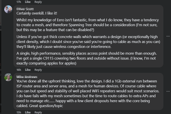

    "I will be using WiFi meshes". You could use a mesh system, but it would work much better if the units were Ethernet cabled back to your router. Better still is to use Wireless Access Points. I use WAPs, but ceiling ones which are PoE ones, they only need just an Ethernet cable. They look like fire alarm units and you have no unsightly wires trailing about. Even with a standard mesh system your have to have somewhere to place them and mains power.
    My setup is VM Hub5 under the floor under the stairs, stays very cool. Plain router, no WiFi, under the stairs with PoE network switch for WAPs and cameras. Ceiling mounted WAPs upstairs and down. V6 in living room, Ethernet cabled back to the router.
