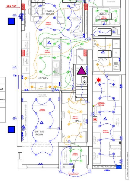

Hi all,
I'm doing a renovation and am confused about how to go about looking into the future in order to get VM in the house.
The below image shows the electrical plan I've made.
My intention is to have the router/networking hub under the stairs (purple triangle) and a VM TV box in the sitting room and family room (blue squares).
The work is still under way - internal walls for example aren't even up.
I will be using WiFi meshes, an ethernet hub & the router will be put into modem mode.
My questions are:
  1. Should holes be drilled in the external walls in preparation for the TV boxes?
  2. If so, will these holes definitely be used by VM?
  3. Is there a VM department where I can talk to someone about the plans and my intentions?
  4. How would I go about having the router put under the stairs (I want the cabling to be as un-noticeable as possible) ?
  5. I'm not sure whether I should use coaxial ports for the TV boxes - are these needed?
In the family room I intend to have a media wall and the TV going over a recess.
The TV box won't be on show - I'm concerned that by doing this we're not going to be able to use the VM box or it'll be dodgy/temperamental.
If anyone can help with the above that'd be great.
Sean

    I hate to complicate the situation further.
    First question to ask is are you in a legacy VM cabled area or one of the new NexFibre FFTP areas. VM now runs three different types of network depending on location & they all have different installation scenarios & also different equipment in the house.
    Also VM only provides TV streaming boxes as standard now. These are WiFI or Ethernet connected, but do NOT record TV channels. V360 recording boxes are only provided by request (at additional cost) in legacy HFC or RFoG network type areas. ALL multiroom boxes are now the streamer type hence no coaxial requirement. The V360 main box does require copper coax from an external source in HFC areas & internally in RFoG areas.
    NexFibre FTTP is a single fibre connection direct to the hub. VM are also well into an upgrade program that will see FTTP being rolled out & eventually replacing HFC/RFoG connections in the coming years.

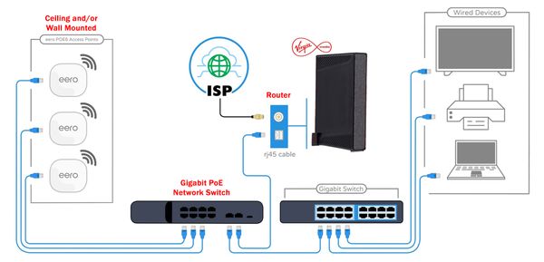

  • Hi, me again.
    Since my initial post I've now decided to be a wired as possible in my renovation.
    To the point where I'm going to have a 24 port gigabit switch, patch panels etc.
    I'm still learning about this and trying to figure things out.
    In my current house (that we rent so can’t make changes to) I have 3x Eero devices (1 plugged into the router).
    I’ve never had an issue with Eero so am going to stick with them.
    I had intended to use these in the new house (they’ll need to be plugged into the mains) but am leaning more towards PoE ones fixed to the ceilings and/or walls.
    Now, when mentioning this to my builder and electrician they said that these are only used in hospitals, offices etc.
    I initially accepted this but this isn’t the case.
    So, they don’t know it yet but I’m going to be doing it.
    As the electrician hasn’t filled me with confidence, I’m looking into all this myself and will either tell him what to do or I’ll get someone in.
    My question is this: Have I understood the setup for my house networking hub?
    The switch I'm looking at is: https://www.screwfix.com/p/tp-link-tl-sg1024d-24-port-desktop-rackmount-network-switch-black/239rn
    And the PoE switch: https://www.screwfix.com/p/labgear-60052pi-s-4-port-4-2-port-poe-10-100-1000mbps-switch-unmanaged-gigabit-poe-network-switch-black/712YE?tc=CB1

      1. Electricians are ok for just putting in the cables, but very few understand networking at all.
      2. As you are starting with a ‘clean sheet’ I would be looking for the future, not some currently old equipment. You need to think about WiFi 7 and access points with all 3 bands, 2.4, 5 and 6 Ghz radios. Also Ethernet 6A cables, Ethernet 7 or 8 cables are not needed at all just waste of money, 6A will cope with 10G up to the distances in a home.
         The equipment  I use is by Ubiquiti/Unifi and I cannot recommend any other at the moment. Most of their latest units support 2.5 and 10 Ghz.
      3. Look at networking outlets, not the well known retail outlets who are mostly networking blind.
      4. Basically it is down to how much you wish to spend.

      Are you planning to use the VM hub as a router and the Eero as access points?
      I have never used Eero before but I would assume its capabilities are far greater than those of a VM hub.
        Eero do actual AP's, so those will be just PoE AP's.  They also do a full blown non wifi router, the Eero Gateway.  Not sure if it's sold in the UK though.  I prefer this method as it doesn't restrict the wifi to a single point.
    Very valid points indeed Tudor​   I would go one further and suggest parts of the core infrastructure could be done with fibre?  Very small diameter cable, interference free, and will do greater speeds for the foreseeable future, but more expensive.
    Also, look at switches with a minimum of 2.5Gb ports, 10Gb uplinks being a must as well.  Again, uplinks can be fibre patched with SPF modules.
    Technology is moving quite fast at the moment, so 1Gb was great not so long ago, but now it's considered as a starting point.  Same with Wifi advances, Wifi 5 was the norm, now it's all about Wifi 7 and triple band.
    If I had the chance to redo my "flood" wiring all over again, I would do it differently for sure.
    Bottom line, how deep are your pockets ...   ;-)

    So, simply put this is what I want
    I've worked out that I'll need 20 cables run around the house - different rooms have different quantities and this number includes a few free ports here and there.  A 24 port unmanaged switch will be fine for my needs.
    I want to be able to be a little dependant on WiFi as possible.  And, the stream box using not WiFi is a good point.... I'm old school and like to record stuff but may eventually get a stream one.
    I know about Ubiquiti but have had no problems with Eero, but will be happy to change if needed.
    Eero have a ceiling/wall mounted PoE access point (https://www.amazon.co.uk/eero-PoE-6/dp/B0DQB3FYGN).  They also have a Gateway (https://support.eero.com/hc/en-us/articles/8959150730267-Introducing-eero-PoE-Gateway) but this isn't available in the UK.
    This is why I was looking into the one I previously posted Labgear PoE because to my eyes, this is essentially the same.
     So, similar to how I currently have the Eero devices set up, the VM router is in modem mode and a Eero device is plugged in - this is now our modem.  Additional Eeros add to the mesh.
    I will certainly not be using the VM hub as a router - the final straw when I was getting 0.03Mbps :D .
    Instead of plugging in Eero devices and have them dotted around the house I was thinking about the PoE ones so it all looked cleaner/tidier.
    In my head the diagram I posted is how it'll work

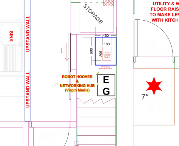

    I was looking at this case https://www.amazon.co.uk/MT-VIKI-Cabinet-Enclosure-Equipment-Included/dp/B0CSK2RX71?th=1
    But in the space I have, it's huge. Blue box and the 24 port switch is to scale too.
    The switch in the image is the 1024D which I've just found out is a desktop version - the 1024 is more suitable to racks (440mm width)
    Now I know this I wonder whether a  server rack is even needed - on the flip side I think it is as I'l want a patch panel to keep things neat.
    The case I looked at has 2.5x more depth than the rack-mountable switch so I need to find something that's more streamlined.
    A question - When I got my new VM hub, it said it needs to be kept upright.  Do you know if this is still the case when in modem mode?
    It'd be a confidence builder if someone can tell me if I'm on the right track with what's in my head :D

      Yes, it does for thermal reasons.
      However, the big point as asked by ​  is about the cabling from VM.  If you are locating the Hub inside, where are you intending to get the cables in from?  Are you in a legacy co-ax area, or a Nexfibre XGS-PON FTTP area, or did I miss this answer?  If co-ax then, yes modem mode is okay, if in a Nexfibre area, then the Hub 5X has no modem mode.
      Irrespective of this, you still need to think of conduit so VM can run the cable(s).  It should also be future proofed for any other ISP cable runs.
      As for the cabinet, it's not really needed unless you need to stop anyone from "poking" at the cables.  You can use any open shelving to set the kit on, with the exception of perhaps the patch panel (if needed).
