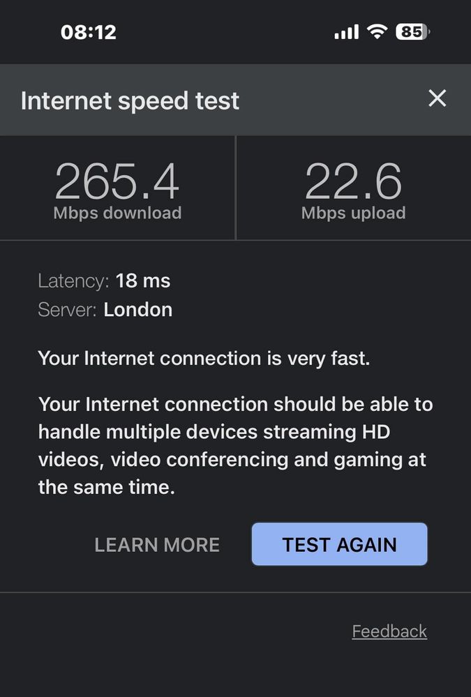

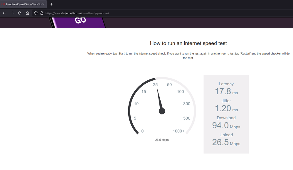

i have checked my hard-wire PC speed test a few times now over a week or so but the speeds only showing 100mbs not the 250mbs i should be getting  but on my Wi-Fi on my phone i get the 250mbs

    This suggests that the PC is only connecting at 100Mbps instead of 1000Mbps.
    Try using a different cable and a different socket on the Hub. Check the ethernet settings in the PC to see its connection speed.
    Is the PC cable connected direct to the VM Hub ?
    i.e. not via a 10/100 switch or a 10/100 Powerline extender or similar.
        Run this speed test, use the FULL test and post the results please.
        www.samknows.com/realspeed
        This will show the speed VM are sending to your Hub, and the speed your PC is receiving.

    That 94.0 Mbps reading is the classic symptom of a 100 Mbps ethernet connection. Do the checks I suggested above.
  • Search for 'Powershell' on your PC, then select 'Windows PowerShell ISE'.
    Copy/paste the below code into the main window at the top, press the green 'Play' button, then copy/paste the results into a reply on here:
