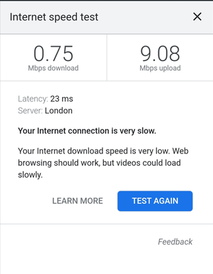

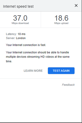

  • So my slow internet speed is on the garden office. The router is 6 metres away from the office and as i sit here I can see the router though the patio doors as it it located at the back of the house.
    When the POD is turned off I get around 30MBPS download. If I turn the POD on however I get around 1-5MBPS download speed.
    It never used to be this way and used to get 60+ in the office but something has changed in the last few weeks. The speed of the POD in the house which are further away from the router is and gives 150MBPS +.
    This is the speed with the POD off:
    With the POD on I get:
