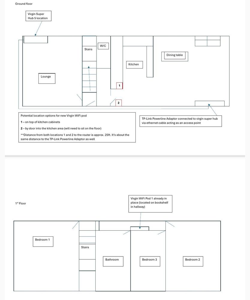

I live in a 3 bed semi-detached Victorian property and currently have:
  • a Super hub 5 router with 1 GB broadband in the lounge
  • a TP-Link power line adaptor at the rear of the property in the dining room which connected to the router via ethernet (basically acts as a wifi access point)
  • a virgin wifi black pod in the upstairs hallway to boost the signal to the bedrooms.
When I first received the wifi pod, I was getting high speeds, often over 100Mbps and sometimes over 200mbps in the bedrooms, however, recently I have been getting anywhere between 20 - 40Mbps, even though nothing has changed in terms of the set up. The pod is also showing as fair / poor on the VM Connect app and I've tried resetting it / refreshing the wifi but it hasn't improved anything. It seems odd that this would have started performing poorer but I have spoken to Virgin today and they have advised they will be sending me another wifi pod so I was after some advice in terms of where I should locate it to hopefully boost the signal up to the one upstairs. The trouble is, I am limited in terms of where I can locate it so I have a couple of options:
  • on top of the kitchen cabinet units
  • plugged into a socket behind the kitchen door but it will need to sit on the floor.
Both these locations are about 25ft from the router in the lounge and will be located almost directly beneath the existing wifi pod upstairs. In the kitchen, the new wifi pod will also be about 25ft from the TP-Link power line adaptor as well. I wondered if anyone is able to provide any advice on locating it on top of kitchen cabinets and also if it will make a noticeable difference having one located directly beneath the other?
I have provided some plans below to show the layout to give some idea but it is not to scale! I have added the 2 locations I have identified for the new wifi pod and the second plan shows the upstairs where the existing pod is located.
Many thanks in advance for any advice / suggestions anyone can provide!

      I do actually have an Ethernet going to the dining room. We had an extension a few years back and I got them to run the cable round. As I knew the router’s signal wouldn’t reach that far. I’d previously had a plug in booster which had worked ok but had its own EXT SSID and I wanted it to be the same throughout. Therefore the TP Link is connected and mirrors the router settings and has always given us really good WiFi speeds so I’ve just never changed it, especially as Virgin make it so difficult to get extra pods. However, it’s getting the speeds and signal upstairs which has been the issue. I got the first WiFi pod from Virgin which did help initially, but recently the speeds have been much lower therefore I thought I would try and get a second one and place it in a position below it in the hope it would improve the signal to the upstairs one.
