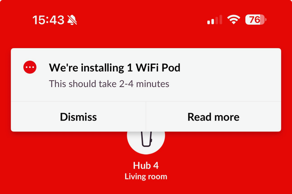

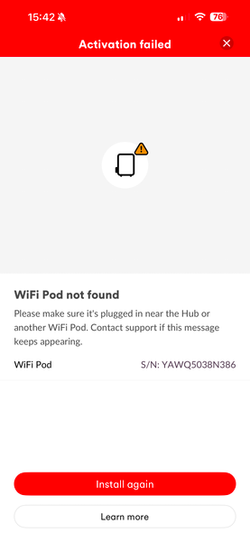

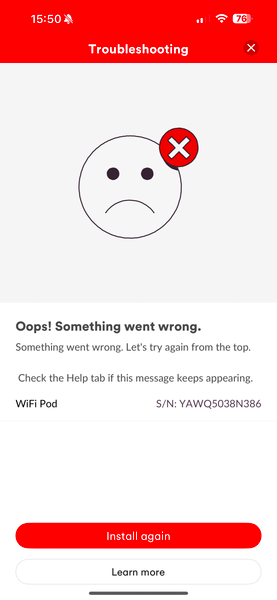

Virgin recently sent me a WiFi pod (black) and I've expended several hours trying various things to get it installed, without success.
  • I have a SuperHub 4 and I'm using the Connect App on iOS 26.2 (iPhone 15 Pro Max).
  • The Connect app reports that installation has failed, and the Pod exhibits a flashing (dull) white light in the lower right corner.

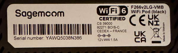

  • The Pod serial number on the device matches that expected by the Connect app.

Some screenshots below ... any ideas?

    Just to follow up and confirm that the Pod is installed and working now.
    I used the VM Connect app on an iPad (Pro)  instead of the iPhone (15 Pro Max) I'd been using for all the many earlier attempts. It worked without issue.
    I don't know whether the change of device made the difference, or if something else had been updated in the meantime (there was a break of 3-4 weeks since my last unsuccessful attempt).
