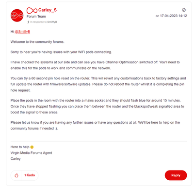

    • SmiffyB's avatar
      SmiffyB
      This worked for me. See the post from Carly-S on 17th April 23

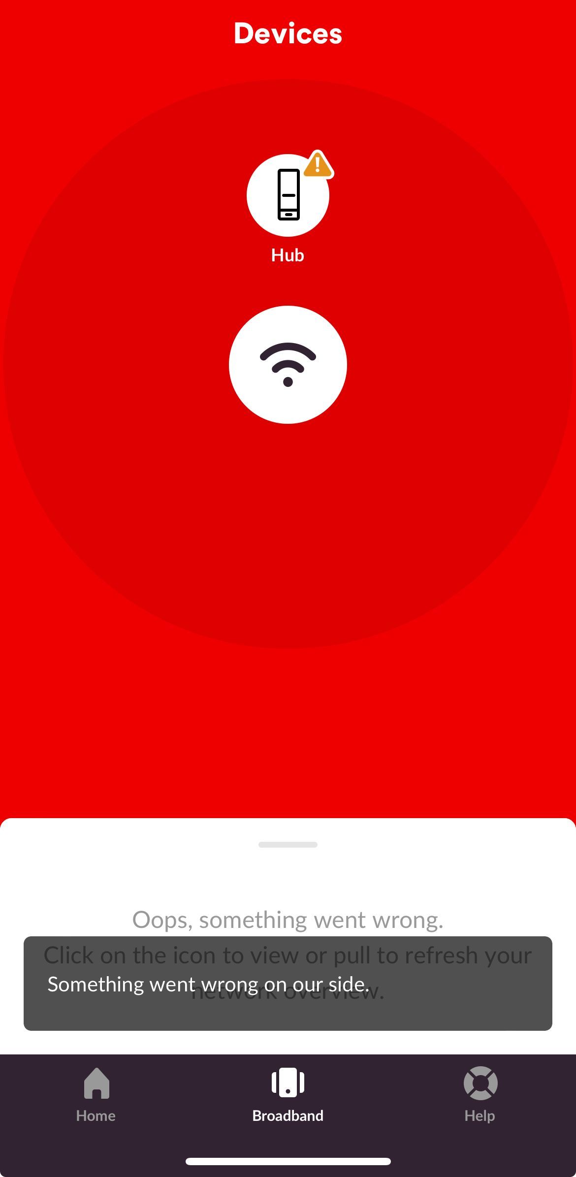

    I’m having exactly the same issue with a WiFi pod I received yesterday: it will flash green for a bit, then blue, then go off for a bit, then start the cycle again. It did it all day, so I turned it off overnight. Have turned it on this morning and no change.
    Having read through this thread, I have tried:
    Rebooting the WiFi router
    Moving the pod into the same room for 15 minutes to see if that helps them connect.
    No matter what I do, the Virgin Connect app will not recognise the pod, and it also seems to have a problem connecting with our router (please see the below screengrab). Every time I try again, it says it’s a problem in Virgin’s side.

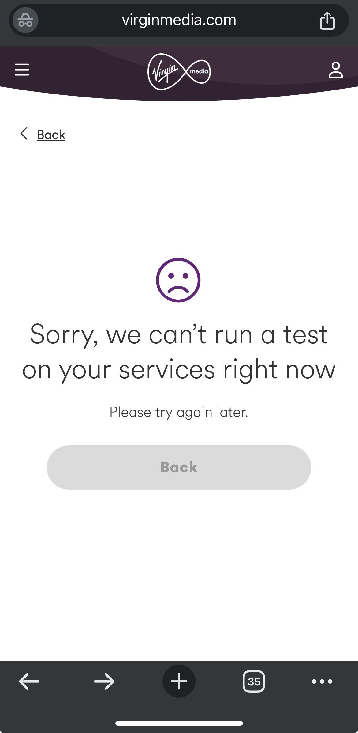

    I also tried running a test on my services, but it said it could not run a test right now (screengrab below).

    • SmiffyB's avatar
      SmiffyB
      My issue was solved following advice from Virgin by resetting the router not just rebooting it....have you tried that?

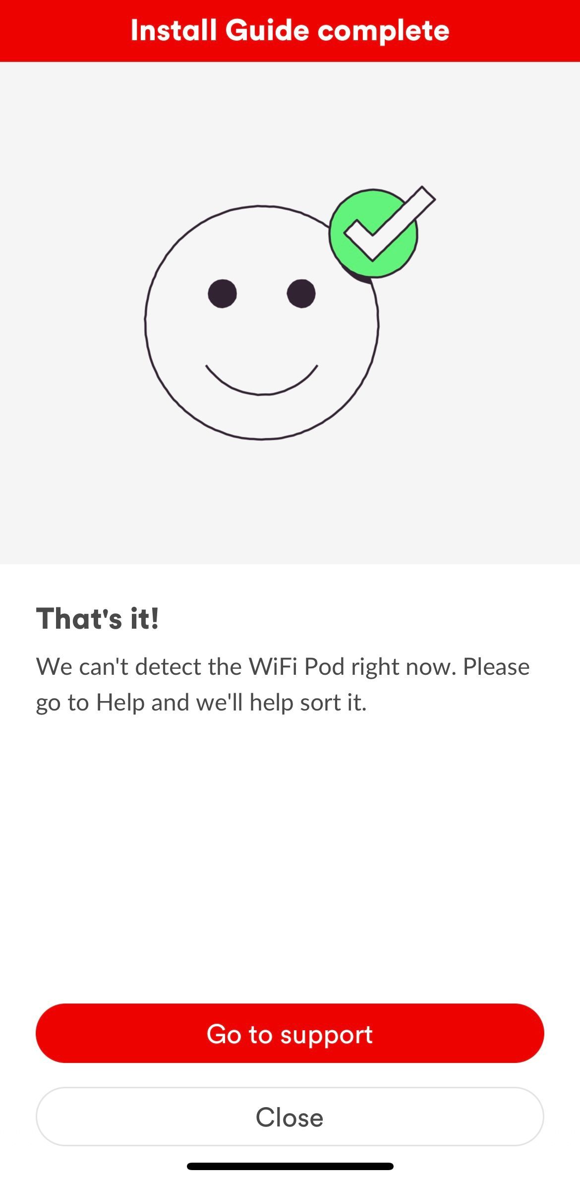

    Still not having any luck with connecting the pod - it just keeps flashing blue, in the main. Green comes back along for a bit..
    The hub is at least registering on the Connect app now, but all I get when I try to install the pod is a failure to detect message (screengrab below), which is no surprise as the Connect app doesn’t recognise the pod. I’ve gone to the Help section, as advised, but I’ve not seen much there beyond trying again.
    After 10+ attempts to install, the app told me it needed to optimise my network, which I was hoping would have solved the issue, but after running the optimisation, I’ve still had no luck.
