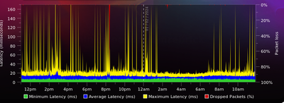

Hi,
I have a Hub 5 in modem mode. Ive noticed that the Upstream modulation has started to fluctuate between 32QAM and 64QAM. This has been happening for over a month now. Initially the modulation would drop to 16QAM and stay between 16 and 32. However, more recently its been sticking at 32QAM, then jumping to 64 and then going back to 32.
Speeds seem to be ok but I have started to notice random packet loss. Last Thursday evening packet loss was very bad but it seems to have stabilised. I have called CS multiple times but the script they follow doesnt seem to have an answer to my issue. Packet loss is still occurring, not as bad, just small amounts randomly. Dont know if anyone can see an issue with my levels?

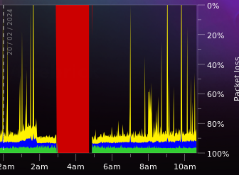

  • Engineer visited on Tuesday, checked the power levels coming in and confirmed they were already in spec. I mentioned an ongoing issue with the street cabinet. He has raised this and Im hoping that Networks will come and tidy up the cabinet (this has probably been the 8th time Ive mentioned the state of the cabinet to a number of engineers).
    Everything was working well until yesterday evening at 8:22 when my connection went down (both Wired and wireless). I looked at the hub 5 logs and it showed "16 consecutive T3 timeouts". Something still isnt right.
    Logs:
    31-01-2024 20:23:01criticalUnicast Maintenance Ranging attempted - No response - Retries exhausted;CM-MAC=;CMTS-MAC=;CM-QOS=1.1;CM-VER=3.1;
    31-01-2024 20:23:01critical16 consecutive T3 timeouts while trying to range on upstream channel 8;CM-MAC=;CMTS-MAC=;CM-QOS=1.1;CM-VER=3.1;
    31-01-2024 20:21:53criticalStarted Unicast Maintenance Ranging - No Response received - T3 time-out;CM-MAC=;CMTS-MAC=;CM-QOS=1.1;CM-VER=3.1;

        I have already tried this before and it has not made any difference. Although this issue isnt constantly happening it does happen very randomly and its annoying when it does because it takes down everything (wired and wireless connections).
        I understand its easy to blame customer equipment but in this case, as you can see from the logs, the hub is timing out which shows that there is an issue between the hub and virgin media's network. My router isnt timing out or dropping out, its your side. Why would my own router logs show "16 consecutive T3 timeouts"? This can be seen from the hub 5 logs.
        I have been monitoring my neighbours virgin media connection and he hasnt had a bunch of T3 timeouts in one go (he has lots of T3 timeouts but not all occurring at once) but he has a hub3. Ive noticed that the large amount of timeouts seem to occur on the 3.1 upstream channel (which the hub3's do not use). Surely there must be something causing those timeouts?
        Could you explain what "16 consecutive T3 timeouts" means?
        I also had a random reboot the morning at 2:50am, but in the log it just says reboot due to unknown. Firmware level is still the same and there has been no power cut.
        Looking forward to your reply.

  • Another reboot this morning, hub 5 logs:
    20-02-2024 02:55:01noticeREGISTRATION COMPLETE - Waiting for Operational status
    20-02-2024 02:54:57noticeUS profile assignment change. US Chan ID: 6; Previous Profile: 13; New Profile: 11 13.;CM-MAC=;CMTS-MAC=;CM-QOS=1.1;CM-VER=3.1;
    20-02-2024 02:54:51noticeDS profile assignment change. DS Chan ID: 32; Previous Profile: ; New Profile: 1 2 3.;CM-MAC=;CMTS-MAC=;CM-QOS=1.1;CM-VER=3.1;
    20-02-2024 02:54:48noticeTLV-11 - unrecognized OID;CM-MAC=;CMTS-MAC=;CM-QOS=1.1;CM-VER=3.1;
    20-02-2024 02:54:45warningDHCP WARNING - Non-critical field invalid in response ;CM-MAC=;CMTS-MAC=;CM-QOS=1.1;CM-VER=3.1;
    20-02-2024 02:54:43noticeHonoring MDD; IP provisioning mode = IPv4
    20-02-2024 02:54:26criticalSYNC Timing Synchronization failure - Failed to acquire QAM/QPSK symbol timing;;CM-MAC=;CMTS-MAC=;CM-QOS=1.1;CM-VER=3.1;
    20-02-2024 02:54:25criticalCable Modem Reboot because of - unknown

  • So engineer said there is packet loss when he did a traceroute reported to networks and was very thorough while at my parents place and spoke freely of the problems which also effects a few of us I'm monitoring. I've noticed they have changed there ip address to wa7 area near the Midlands (monitoring?) we are all in Bristol. Hasn't rang back as of yet he rang last week and said to give him some time a day or 2 which I gave a week, specs below problems persist. He didn't sound optimistic saying that all of Bristol was ****** and wouldn't have any sort of time on a fix, can I get a ticket number? He put a double forward path as 3.1 was 11dbmv that's nearly centered the 3.0 and 3.1 is now at 5.2 even though -9 total was put on.

      Im no expert, but that those stats look ok to me. Ignore the Pre RS errors and corrected errors (3.1 channel). Its the post RS and uncorrected errors you need to be worried about. If they start to rise quickly then theres a fault.
      Regarding packet loss, how are you measuring this? I have a few BQM's on a few houses down my street and compare packet loss and issues with their graphs. If  we all have blips at the same time then I know its an area issue if its just me or them then its something local to our setup. My firewall also shows me if there is packet loss on my WAN connection, thats the way I know if there are problems.
